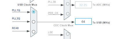

The clock resolve chooses 64MHz for USB:
whereas the correct USB clock frequency is 48MHz:
I would expect the clock configuration GUI to flag this issue for me and set up the correct frequency of 48MHz for USB when running the clock resolver.

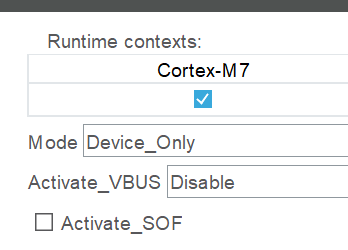

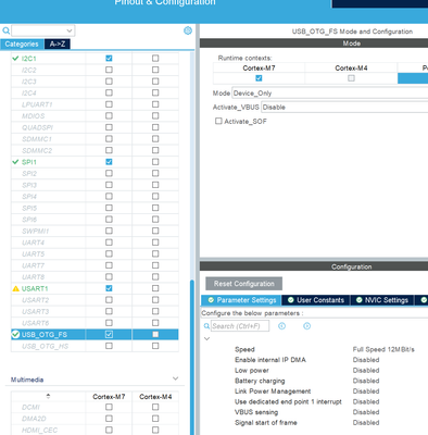

Just in case this is relevant, this is what my USB setup looks like:

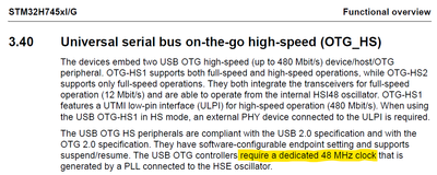

I confirm CubeMX should not exceed the required value for the controller as detailed in datasheet. Internal PHY clock is running at 48MHz whatever the speed is. An internal ticket 179358 is submitted to dedicated team.

Choose MCU STM32H745IIK6 when creating a new project.
Agree to apply the default configuration of the MPU.

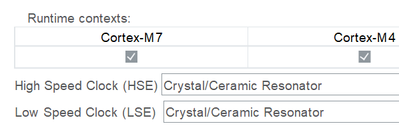

Enable support for HF/LF crystal oscillators and enable USB FS device mode:

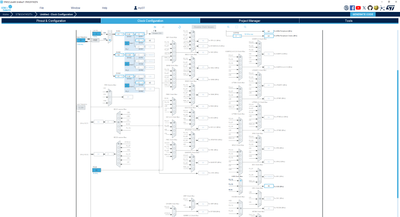

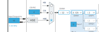

Enable HSE and set the input frequency to 16 MHz:

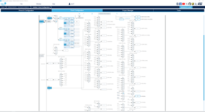

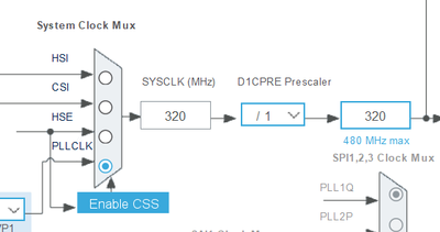

Choose PLLCLK and set MCU core frequency to 320 MHz:

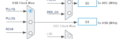

Once the clock tree is automatically updated, "to USB" frequency is automatically set to 64 MHz:
