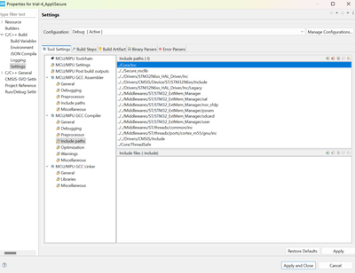

Using the latest CubeMX 6.15.0 I was generating ThreadX for Secure - Non Secure Project (for STM32N6 - Cortex_M55).
This did not add file : "\Middlewares\ST\threadx\ports\cortex_M55\gnu\src\txe_thread_secure_stack_allocate.c" and so is not added in to the CubeIDE project.
Where as it's counterpart - "\Middlewares\ST\threadx\ports\cortex_M55\gnu\src\txe_thread_secure_stack_free.c" is getting generated and added to the project.
Also, compiler includes like "/Secure_nsclib" , "/Drivers/CMSIS/Include" did not get added into the Compiler Include Paths in the CubeIDE project that this CubeMX generates.

Hello @prapk-engr
Regarding the missing file txe_thread_secure_stack_allocate.c, thank you very much for bringing this issue to our attention.
I have raised this issue with our development team for resolution under internal ticket 216459.
As for your second point, after reviewing the compiler include paths, I can confirm that both /Secure_nsclib and /Drivers/CMSIS/Include have been successfully added.
THX
