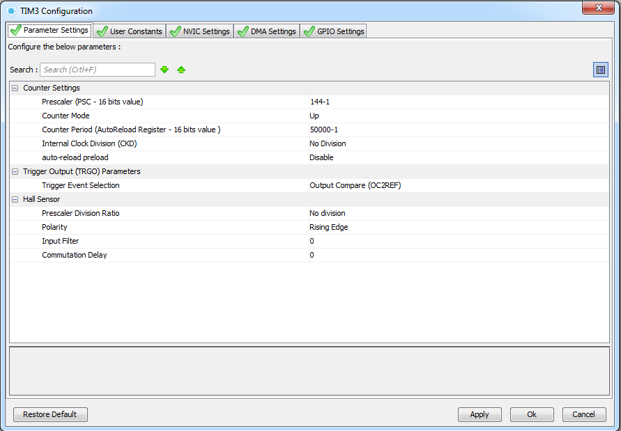

I am trying to configure the timers for a BLDC applications, so that the hall sensor change triggers another timer.
In cube, If you configure a timer as XOR ON/ Hall Sensor Mode, you can't configure it as a Master Timer.
In the configuration, the Master/Slave Mode disappears, and in the generated code, it automatically selects disabled.
Cube 4.23.0
