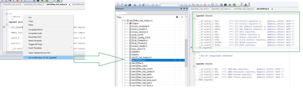

When enabling SMBus mode through STM32CubeMX interface, #define HAL_SMBUS_MODULE_ENABLED will be uncommented, so the stm32f4xx_hal_smbus.h file will be included and there's no need to enable the HAL_I2C_MODULE.
Furthermore, the I2C_TypeDef structure (in stm32f4xx_hal_smbus.h file) is defined in the stm32f401xe.h which is the CMSIS STM32F401xE Device Peripheral Access Layer Header File containing :
- Data structures and the address mapping for all peripherals
- peripherals registers declarations and bits definition
- Macros to access peripheral’s registers hardware
Noting that I'm executing a simple test case using STM32F401RETx MCU, but this is generic for all MCUs supporting SMBus peripheral.

‎2021-06-09 1:11 AM
Hi Khouloud,
I must admit that I didn't keep that project setup. And now I'm working with a different setup, so I don't see the problem.
Like you, I cannot reproduce it just from a blank template. Most likely it was a mistake of mine - it was my first attempt at configuring a project with CubeMX. So don't spend more time on it ;)
