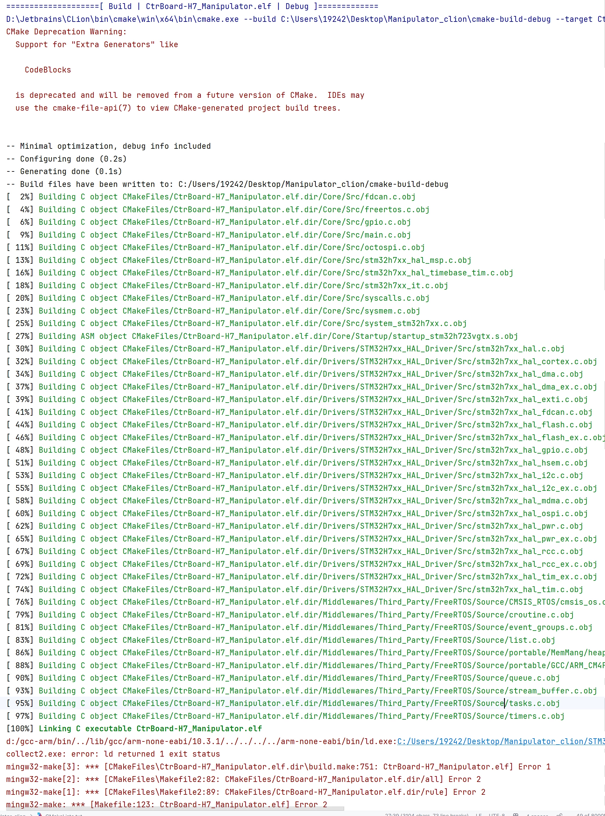

CLion show error:
====================[ Build | CtrBoard-H7_Manipulator.elf | Debug ]=============
D:\Jetbrains\CLion\bin\cmake\win\x64\bin\cmake.exe --build C:\Users\19242\Desktop\Manipulator_clion\cmake-build-debug --target CtrBoard-H7_Manipulator.elf -- -j 6
CMake Deprecation Warning:
Support for "Extra Generators" like
CodeBlocks
is deprecated and will be removed from a future version of CMake. IDEs may
use the cmake-file-api(7) to view CMake-generated project build trees.
-- Minimal optimization, debug info included
-- Configuring done (0.2s)
-- Generating done (0.1s)
-- Build files have been written to: C:/Users/19242/Desktop/Manipulator_clion/cmake-build-debug
[ 2%] Building C object CMakeFiles/CtrBoard-H7_Manipulator.elf.dir/Core/Src/fdcan.c.obj
[ 4%] Building C object CMakeFiles/CtrBoard-H7_Manipulator.elf.dir/Core/Src/freertos.c.obj
[ 6%] Building C object CMakeFiles/CtrBoard-H7_Manipulator.elf.dir/Core/Src/gpio.c.obj
[ 9%] Building C object CMakeFiles/CtrBoard-H7_Manipulator.elf.dir/Core/Src/main.c.obj
[ 11%] Building C object CMakeFiles/CtrBoard-H7_Manipulator.elf.dir/Core/Src/octospi.c.obj
[ 13%] Building C object CMakeFiles/CtrBoard-H7_Manipulator.elf.dir/Core/Src/stm32h7xx_hal_msp.c.obj
[ 16%] Building C object CMakeFiles/CtrBoard-H7_Manipulator.elf.dir/Core/Src/stm32h7xx_hal_timebase_tim.c.obj
[ 18%] Building C object CMakeFiles/CtrBoard-H7_Manipulator.elf.dir/Core/Src/stm32h7xx_it.c.obj
[ 20%] Building C object CMakeFiles/CtrBoard-H7_Manipulator.elf.dir/Core/Src/syscalls.c.obj
[ 23%] Building C object CMakeFiles/CtrBoard-H7_Manipulator.elf.dir/Core/Src/sysmem.c.obj
[ 25%] Building C object CMakeFiles/CtrBoard-H7_Manipulator.elf.dir/Core/Src/system_stm32h7xx.c.obj
[ 27%] Building ASM object CMakeFiles/CtrBoard-H7_Manipulator.elf.dir/Core/Startup/startup_stm32h723vgtx.s.obj
[ 30%] Building C object CMakeFiles/CtrBoard-H7_Manipulator.elf.dir/Drivers/STM32H7xx_HAL_Driver/Src/stm32h7xx_hal.c.obj
[ 32%] Building C object CMakeFiles/CtrBoard-H7_Manipulator.elf.dir/Drivers/STM32H7xx_HAL_Driver/Src/stm32h7xx_hal_cortex.c.obj
[ 34%] Building C object CMakeFiles/CtrBoard-H7_Manipulator.elf.dir/Drivers/STM32H7xx_HAL_Driver/Src/stm32h7xx_hal_dma.c.obj
[ 37%] Building C object CMakeFiles/CtrBoard-H7_Manipulator.elf.dir/Drivers/STM32H7xx_HAL_Driver/Src/stm32h7xx_hal_dma_ex.c.obj
[ 39%] Building C object CMakeFiles/CtrBoard-H7_Manipulator.elf.dir/Drivers/STM32H7xx_HAL_Driver/Src/stm32h7xx_hal_exti.c.obj
[ 41%] Building C object CMakeFiles/CtrBoard-H7_Manipulator.elf.dir/Drivers/STM32H7xx_HAL_Driver/Src/stm32h7xx_hal_fdcan.c.obj
[ 44%] Building C object CMakeFiles/CtrBoard-H7_Manipulator.elf.dir/Drivers/STM32H7xx_HAL_Driver/Src/stm32h7xx_hal_flash.c.obj
[ 46%] Building C object CMakeFiles/CtrBoard-H7_Manipulator.elf.dir/Drivers/STM32H7xx_HAL_Driver/Src/stm32h7xx_hal_flash_ex.c.obj
[ 48%] Building C object CMakeFiles/CtrBoard-H7_Manipulator.elf.dir/Drivers/STM32H7xx_HAL_Driver/Src/stm32h7xx_hal_gpio.c.obj
[ 51%] Building C object CMakeFiles/CtrBoard-H7_Manipulator.elf.dir/Drivers/STM32H7xx_HAL_Driver/Src/stm32h7xx_hal_hsem.c.obj
[ 53%] Building C object CMakeFiles/CtrBoard-H7_Manipulator.elf.dir/Drivers/STM32H7xx_HAL_Driver/Src/stm32h7xx_hal_i2c.c.obj
[ 55%] Building C object CMakeFiles/CtrBoard-H7_Manipulator.elf.dir/Drivers/STM32H7xx_HAL_Driver/Src/stm32h7xx_hal_i2c_ex.c.obj
[ 58%] Building C object CMakeFiles/CtrBoard-H7_Manipulator.elf.dir/Drivers/STM32H7xx_HAL_Driver/Src/stm32h7xx_hal_mdma.c.obj
[ 60%] Building C object CMakeFiles/CtrBoard-H7_Manipulator.elf.dir/Drivers/STM32H7xx_HAL_Driver/Src/stm32h7xx_hal_ospi.c.obj
[ 62%] Building C object CMakeFiles/CtrBoard-H7_Manipulator.elf.dir/Drivers/STM32H7xx_HAL_Driver/Src/stm32h7xx_hal_pwr.c.obj
[ 65%] Building C object CMakeFiles/CtrBoard-H7_Manipulator.elf.dir/Drivers/STM32H7xx_HAL_Driver/Src/stm32h7xx_hal_pwr_ex.c.obj
[ 67%] Building C object CMakeFiles/CtrBoard-H7_Manipulator.elf.dir/Drivers/STM32H7xx_HAL_Driver/Src/stm32h7xx_hal_rcc.c.obj
[ 69%] Building C object CMakeFiles/CtrBoard-H7_Manipulator.elf.dir/Drivers/STM32H7xx_HAL_Driver/Src/stm32h7xx_hal_rcc_ex.c.obj
[ 72%] Building C object CMakeFiles/CtrBoard-H7_Manipulator.elf.dir/Drivers/STM32H7xx_HAL_Driver/Src/stm32h7xx_hal_tim_ex.c.obj
[ 74%] Building C object CMakeFiles/CtrBoard-H7_Manipulator.elf.dir/Drivers/STM32H7xx_HAL_Driver/Src/stm32h7xx_hal_tim.c.obj
[ 76%] Building C object CMakeFiles/CtrBoard-H7_Manipulator.elf.dir/Middlewares/Third_Party/FreeRTOS/Source/CMSIS_RTOS/cmsis_os.c.obj
[ 79%] Building C object CMakeFiles/CtrBoard-H7_Manipulator.elf.dir/Middlewares/Third_Party/FreeRTOS/Source/croutine.c.obj
[ 81%] Building C object CMakeFiles/CtrBoard-H7_Manipulator.elf.dir/Middlewares/Third_Party/FreeRTOS/Source/event_groups.c.obj
[ 83%] Building C object CMakeFiles/CtrBoard-H7_Manipulator.elf.dir/Middlewares/Third_Party/FreeRTOS/Source/list.c.obj
[ 86%] Building C object CMakeFiles/CtrBoard-H7_Manipulator.elf.dir/Middlewares/Third_Party/FreeRTOS/Source/portable/MemMang/heap_4.c.obj
[ 88%] Building C object CMakeFiles/CtrBoard-H7_Manipulator.elf.dir/Middlewares/Third_Party/FreeRTOS/Source/portable/GCC/ARM_CM4F/port.c.obj
[ 90%] Building C object CMakeFiles/CtrBoard-H7_Manipulator.elf.dir/Middlewares/Third_Party/FreeRTOS/Source/queue.c.obj
[ 93%] Building C object CMakeFiles/CtrBoard-H7_Manipulator.elf.dir/Middlewares/Third_Party/FreeRTOS/Source/stream_buffer.c.obj
[ 95%] Building C object CMakeFiles/CtrBoard-H7_Manipulator.elf.dir/Middlewares/Third_Party/FreeRTOS/Source/tasks.c.obj
[ 97%] Building C object CMakeFiles/CtrBoard-H7_Manipulator.elf.dir/Middlewares/Third_Party/FreeRTOS/Source/timers.c.obj
[100%] Linking C executable CtrBoard-H7_Manipulator.elf
d:/gcc-arm/bin/../lib/gcc/arm-none-eabi/10.3.1/../../../../arm-none-eabi/bin/ld.exe:C:/Users/19242/Desktop/Manipulator_clion/STM32H723VGTX_FLASH.ld:91: non constant or forward reference address expression for section .ARM.extab
collect2.exe: error: ld returned 1 exit status
mingw32-make[3]: *** [CMakeFiles\CtrBoard-H7_Manipulator.elf.dir\build.make:751: CtrBoard-H7_Manipulator.elf] Error 1
mingw32-make[2]: *** [CMakeFiles\Makefile2:82: CMakeFiles/CtrBoard-H7_Manipulator.elf.dir/all] Error 2
mingw32-make[1]: *** [CMakeFiles\Makefile2:89: CMakeFiles/CtrBoard-H7_Manipulator.elf.dir/rule] Error 2
mingw32-make: *** [Makefile:123: CtrBoard-H7_Manipulator.elf] Error 2
i can't understand why this is error:

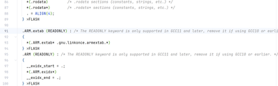

Best answer by Pavel A.
Remove "(READONLY)" in line 93 and everywhere below it.
.ARM.extab (READONLY) : /* The READONLY keyword is only supported in GCC11 and later, remove it if using GCC10 or earlier. */
 Or update your ARM toolchain to GCC 11 or newer as the comment says,

Pavel A.
March 23, 2024
This is linker (ld) error, it does not like something in the .ld file:
C:/Users/19242/Desktop/Manipulator_clion/STM32H723VGTX_FLASH.ld line 91
But you don't show us this file ((
chenmoAuthor
March 23, 2024
Because this is generated by cubemx itself, I don't think there are any major issues when I look at it

Pavel A.
Pavel A.Best answer
March 23, 2024
chenmoAuthor
March 23, 2024
thank you!!!!
it works!
