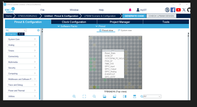

We are using MIPI-DSI on a STM32U5G9NJ.
First bug: There are 2 pins missing in the Pinout View: D4 and J9. Both are VDD11 pins.
Second bug:
After Enabling LTDC and DSI in STM32CubeMX I can't select "Active High" for "Data Enable Polarity" in LTDC -> Parameter settings.

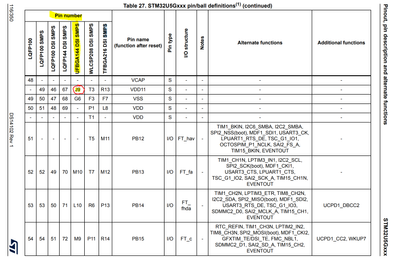

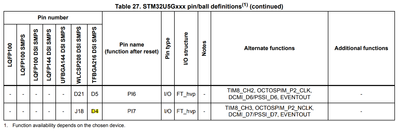

The package that matches with the STM32U5G9NJ is : TFBGA216 DSI SMPS.
This package does not include a pin with J9 number :
And includes PI7 pin

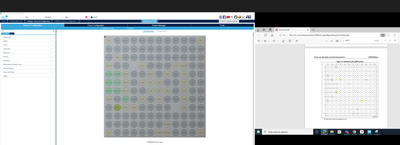

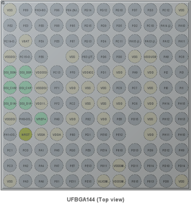

I'm sorry, after writing some of the text I changed the package without double-checking that both bugs are present in this one.
The faulty package is exactly the UFBGA-144, therefore the STM32U5G9ZJ.
Take a look:
That's why I'm telling you to update your configuration and documentation.
