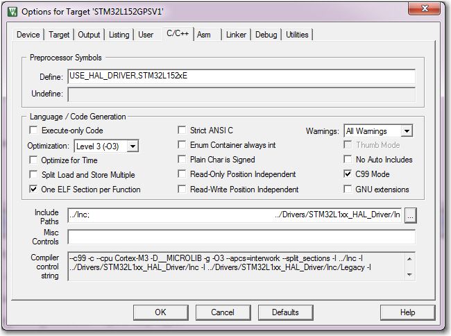

I did that, but I can't compile with .cpp after I put --cpp on my compiler, it gave me a lot of errors, I use Keil for compiling.
What should I change to make it compatible between C and C++?
‎2019-06-30 6:26 AM
Which errors? No need to use --cpp, Keil's compiler will detect c++ file by .cpp extension.,
By the way, which Keil compiler are you using: V5 (armcc) or V6 (clang-like) ?
-- pa
‎2019-06-30 6:38 AM
I use uVision V5.26.2.0
