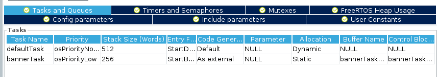

The GUI interface for defining FreeRTOS tasks dictates that stack size is specified in words. That generates a call to CMSIS V2's osThreadNew() which requires attributes.stack_size to be specified in bytes. (The CMSIS layer then divides that by 4 to convert it back words before passing it to FreeRTOS which dictates it's specified in words).
The GUI gets it right for Static tasks, but appears to get it wrong for Dynamic tasks. For example, the above selection in the GUI produces the following correct code for the static case. It declares the array to be 256 words long, and sets stack size to 1024 bytes.
uint32_t bannerTaskBuffer[ 256 ];
osStaticThreadDef_t bannerTaskControlBlock;
const osThreadAttr_t bannerTask_attributes = {
.name = "bannerTask",
.stack_mem = &bannerTaskBuffer[0],
.stack_size = sizeof(bannerTaskBuffer),
In contrast, the size for the dynamic task is passed through to .stack_size unchanged:
const osThreadAttr_t defaultTask_attributes = {
.name = "defaultTask",
.priority = (osPriority_t) osPriorityNormal,
.stack_size = 512
so it's requesting 512 bytes as per the CMSIS V2 API, which the intermediate layer turns into 128 words before calling down to FreeRTOS. So while I specified 512 words in the GUI, I only got 1/4 of that.

2020-02-05 5:08 AM
Hello @David Bathurst
I will check this problem.
Best Regards,
Khouloud
2020-02-05 5:44 AM
@David Bathurst Issue fixed , you will receive the fix with the 5.6.0 MX version.
Thanks for your feedback.
Best Regards,
Khouloud
2020-02-05 1:34 PM
Excellent, thanks Khouloud.
