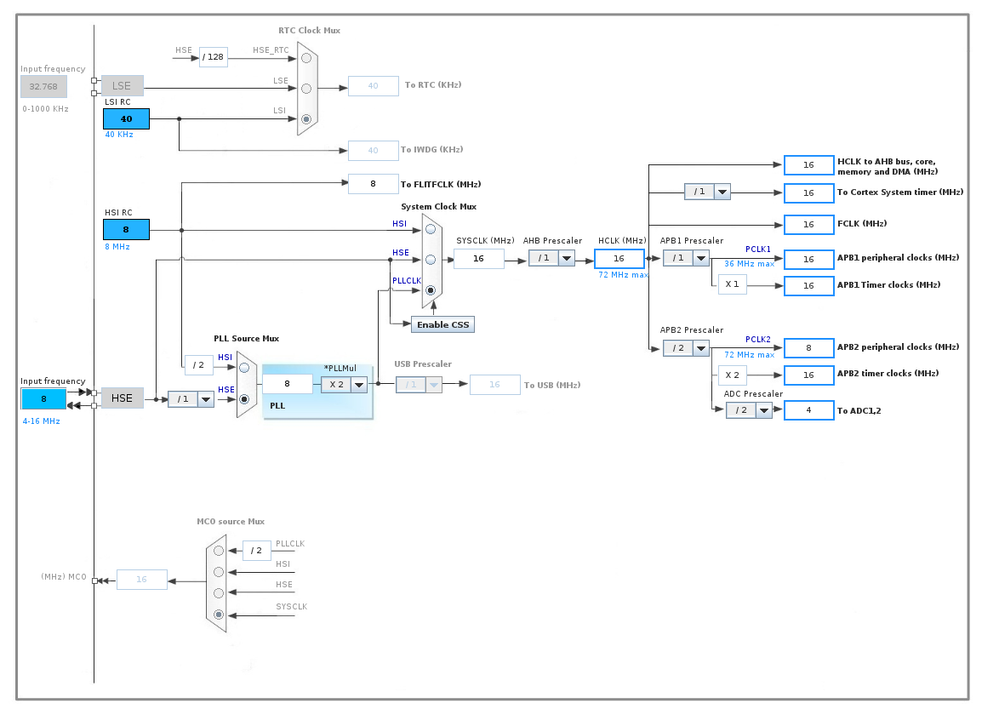

I have just updated one of my projects to STM32F1 FW 1.6.0, and my code was not able to compiled anymore. IOC file attached.
Here is my clocking scheme:
As you can see the LSI oscillator is not used, so I assume this is why the LSI_VALUE is not generated to the stm32f1xx_hal_rcc.h file. However the LSI_VALUE constant is still used in the stm32f1xx_hal_rcc_ex.c:

‌,Using the ioc file you have shared, I'm not facing any compilation issue: The 'LSI_VALUE' is defined in file 'stm32f1xx_hal_conf.h'.
Are you using the STM32CubeMX Version 4.0?

To answer your question: yes I am using the 4.0 What I have forgotten to mention that I have generated code for the STM32 Workbench target. Please see my stm32f1xx_hal_conf.h attached, I cannot find the LSI_VALUE defined there.

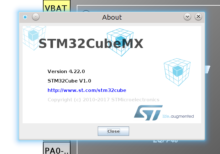

‎2017-08-15 3:41 AM
Hello
garsi.khouloud
,I have created a blank project for the same MCU, and it does not generate the LSI value constant.
I have forgotten to mention that I am running the CubeMX under Linux. I think it should not matter, but it seems to be.

Hi
Marton.Miklos
‌,Previously, I have tested your project (using your shared ioc) under Windows OS; and I was not able to reproduce the issue. Taking into consideration that you're running the CubeMX tool under Linux, our teams will further investigate. Thanks for adding this detail.
We will keep you posted about any further update and we apologize for any inconvenience this may have caused.
