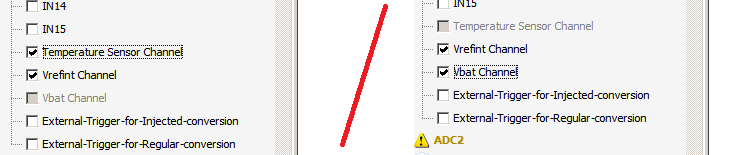

Bug Report: STM32CubeMX 4.8.0 disallows selection of ADC1 channels Vbat or temperature
philip239955
Posted on June 17, 2015 at 01:17
I can't select ADC1 channels Vbat and temperature sensor at the same time. The reference manual mentions a restriction where those channels cannot be selected at the same time for the STM32F42x/STM32F43x in section 13.3.3, but it does not mention that restriction for the 40x/41x. I would expect them to both be selectable for my STM32F405, as they are on different channels (18 and 16, respectively).

Hello Philip,
I confirm this issue with CubeMX when using STM32F405/407/415/417.
Thanks for reporting, it will be fixed in coming release.
