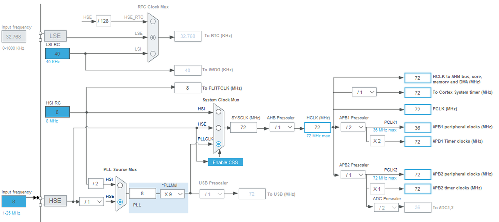

Board: NUCLEO F103RB I have this problem with UART, the serial monitor show: x⸮x⸮x⸮x⸮... Why i have this beaheviour? I use UART2 (PA2 - PA3 board pin) and I connect the board at the PC trought USB cable.
Francesco_
This is the code:

This is the UART config:

The attachment show the clock configuration:0693W000000TwCNQA0.png
You are hard to help. You have no test equipment, you don't post a complete compilable project.
Check that the solder bridges (SB) for the MCO / HSE are present. This may depend on board version in uses, and most of the HAL examples for the NUCLEO-F103RB use HSI to clock at 64 MHz. Boards MB1136 C-01 don't have HSE connected.

Francesco_
Solved, switch on HSI in the CLock Configuration.
Why do i have problem when use HSE and PLLCLK?
Francesco_
Can someone help me?
UART2 works correctly only if PCLK1 = 8 MHz with HSI source at 8 MHz. I want UART2 works correctly with the same of clock configuration on the picture.
Take a look at "6.7.1 OSC clock supply" in the user manual UM1724.
Set up the HSE clock in BYPASS mode and it should work.

I have change HSE in BYPASS mode: RCC_OscInitStruct.HSEState = RCC_HSE_BYPASS, however the UART print: x⸮
I think that there is a problem in BRR register. Why if PCLK1 = 36 MHz at 9600 boud the value of BRR is 0x00000068?
I think that should be 0x00000EA6 (36.000.000/9600). It is correct?
You have a clock problem somewhere. Note that 0x68 * 9600 = 1MHz so the system might be set at that rate for some reason. You should verify your system clock is getting set correctly. Or it could be a CubeMX bug.

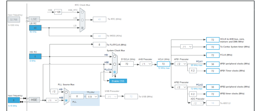

This is the Clock Configuration:

Where could be the problem? The clock configuration is consistent with the picture ( CubeMX).
Francesco_
Also RCC_CFGR = 0x001D3F00 is wrong! Because APB1 and APB2 prescaler are set on "HCLK divided by 16", but should be set on "HCLK divided by 2" and "HCLK not divided" rispectivly.
Why I have this issue?
Going to have to debug and examine registers and code. Hard to troubleshoot remotely with random code fragments.
Make sure HSE_VALUE is defined correctly. Use a scope, check the clock sources, and bit rates.

"Going to have to debug and examine registers and code" -> I check that RCC_CR = 0x01074983, HSE source is enabled. I search HSE_VALUE, i think that is ok.
