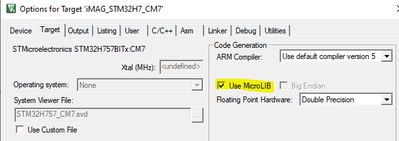

Hi
I add ethernet communication to my program with STM32CubeMx and I just compiled and run it. I have a problem:
if I disconnect Jlink the board I have a ping error. but I run the code with 3 times click on run in MDK-ARM the board will ping.
I also try my app without
MX_LWIP_Init();
if I comment this line all thing is good.

Visitor II
November 27, 2023
I had the same problem. This is caused by the use of printf in the LWIP library. The Retarget.c file must be added to the project, or just add this smal code to main.c
struct __FILE { int handle; };
FILE __stdout;
int fputc(int c, FILE *f) {
 return (0);

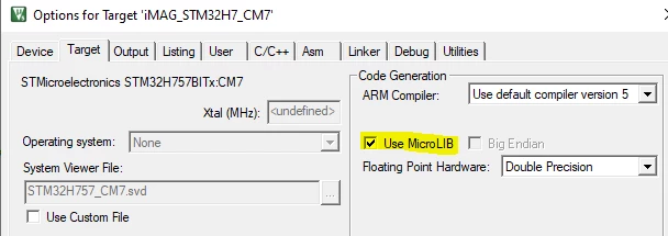

August 19, 2024
Try with enabling microLib option
Thanks & Regards
