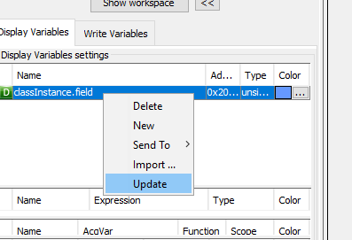

Hey,
I struggled with CubeMonitor for some while as I'm moving from C to C++ in one project. I was really disappointed when it turned out STMStudio does not support adding class members to the variable list, and it only sees the class objects. Cube Monitor is so useless I even thought of using a custom script to look for a variable address using gdb and automatically switching them in the STMStudio project config files. However it turned out I don't have to - you can simply place a new variable, manually add its name (for example classInstance.filed), and although it wont show up on the import variable list window, when you click update the address will be found just fine (and later will be updated when it changes during sw development).
This actually solves two problems - inability to work with C++ members and the error storm that happens when you try to add variable using the import variable popup.
Hope this helps, and someday ST revisits STMstudio project. In my field (motor control) its the best debug tool there is.

‎2022-12-28 12:04 AM
Hey,
So in the first step I import the elf file like it should be done - using the popup (and i get a lot od errors which I close manually - you have to be careful because holding enter key may be too fast and you'll end up on another batch of errors since enter also confirms the elf file you've selected). When the file is already saved in the project you can just add a new variable like I've mentioned previously.
If you'd like you can send me the elf file and I can try to import a variable on my setup :)
‎2022-12-29 10:24 AM
You are right, it works! Thanks a lot. It is better to click with the mouse button instead of the enter key to avoid restarting the import.
A big step forward, thanks again.
