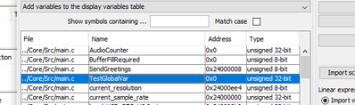

Thanks for a quick response! Would you be able to provide the *.elf file you've tried? I will look into that.
Do you have GDB installed and added to your PATH? You can check it by typing gdb in the windows cmd.
‎2023-07-05 7:37 AM
This is a link to the elf file: https://we.tl/t-Uua8jDQ3W2
Try to visualize the uint32_t variable named TestGlobalVar
gdb is installed and PATH is ok.
Regards
Alberto
‎2023-07-05 12:26 PM
Thank you, Alberto!
I think this variable might be unused and maybe you have some optimization turned on? I can see STMStudio sees it, but it's address is invalid (0x00).
Other variables seem to work fine in STMViewer:
Though it's an interesting case that STMStudio sees it. I think it depends on the GDB version (STMStudio provides it's own GDB). I will investigate that. In the meantime, please let me know if other variables are working fine.

Piotr, unfortunately I can't make it find the address of any variable, like SendGreetings.
I will do more tests next Monday, for now what I tried is:
Substitute / with \ in the .elf path
Put the .elf in the StmViewer.exe folder and load it without \ or /
Put the .elf in C:\ to have the path as short as possible
insert the variable's name with or without the trailing space that is inserted when "add var" is pressed
Thanks again and have a good weekend
Alberto

In the future I will certainly do so.
But for now it's not needed because I was able to make it work.
It was just a matter of using another version of GDB. I was using 11.2, now it is 13.2, from https://github.com/brechtsanders/winlibs_mingw/releases/download/13.1.0-16.0.5-11.0.0-ucrt-r5/winlibs-i686-posix-dwarf-gcc-13.1.0-llvm-16.0.5-mingw-w64ucrt-11.0.0-r5.zip
