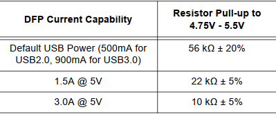

a USB3.0 to USB-C cable has an internal Pull-up resistor from CC to VDD which indicates/simulates the power capability
you need a cable with 10k Resistor for the STLINK-V3PWR
The STLINK-V3PWR don't cares about the current the USB3.0 Port actually deliveres,
it only checks the resistor! It is even possible to operate the STLINK-V3PWR on a 500mA Port if the cable indicates the 3Amps with the 10k pullup.

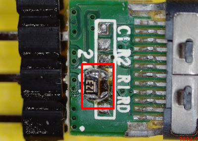

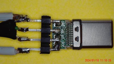

January 18, 2024
Hi @Mikroproc ,
i used a USB-HUB (2.0 or 3.0) and a standard USB2.0 Cable
Cut the USB2.0 Cable on the other side
Connected the open end to a USB-C Adapter-Board (https://www.ebay.de/itm/183278368973)
The Power Supply is external (i left the VCC Connection from USB-A to USB-C open)
USB-A_VCC --- (no connection)
USB-A_GND --- USB-C_GND
USB-A_D+ (green) --- USB-C_A6
USB-A_D- (white) --- USB-C_A7
Ext. Power Supply_+5V --- USB-C_VCC
Ext. Power Supply_GND --- USB-C_GND
The USB-C adapter board comes with a 56k resistor installed (CC to VCC)
I soldered a 12k resistor parallel
Good luck, Fred

Please have a look on the UM3097 Source measurement unit (SMU) and debugger/programmer for STM32 microcontrollers . In chapter §5.3 "USB connection with a host PC", I detailed the pre-requisite of the host PC port to connect the STLINK-V3PWR with a summary on Table4.
In few  words:
  • the STLINK-V3PWR does not enable the two outputs (OUT and AUX) when it is connected to a Standard Downstream Port (Type-A). It is the reason why you got the "error Power measurement not available. Please use a more powerful USB port." popup on the STM32CubeMonitor-Power PC software.
  • The STLINK-V3PWR works well with a Type-C USB PC or hub port (supporting natively either 1.5A or 3A) or a Type-A USB PC or hub port supporting CDP* (Charging Downstream Port) supporting natively 1.5A.
*  have a "spark" logo marking closed to the USB PC or hub port.
If your PC does not have Type-C or Type-A supporting CDP, you can alternatively use a USB hub supporting CDP.
