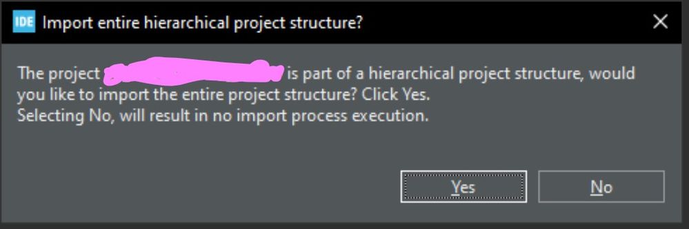

I have an issue here with the IDE. i have few projects compressed in .rar that I am using since the start of the year and everything worked well until this week. When i try to import one of these projects (any project) to my IDE, it shows me this window:
And it always showed something like "Import Successfully"...
I am using version 1.16.1 and i tried to downgrade to 1.14.0 because in other computer with this version still works.
I have checked the .cproject and .project files but everything seems well... I am 99% sure that is anything about the IDE.
Why it is happenning to me? How can i solve this issue?
Thank you so much.

Hello @rubenles ,
Are you using the "Copy into workspace" option ?
Maybe you have this known issue:
| 68184 | Hierarchical projects cannot be imported with the option Copy into workspace. |
listed in the STM32CubeIDE:STM32CubeIDE errata 1.16.x - stm32mcu

Hi Imen.D.
I am openning the project by double clicking on the .cproject file and then, the window i add before appears. It has no option to show any issue... I can't import this project basically.
