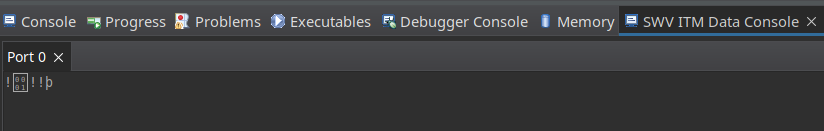

just for fun...i tried on F303 simple test (program is only "blink LED" ;
tried with old st-link V2, this coming from console
_legacyfs_online_stmicro_images_0693W00000dDX01QAG.pngshould be: printf("clearScreen \n\r");
