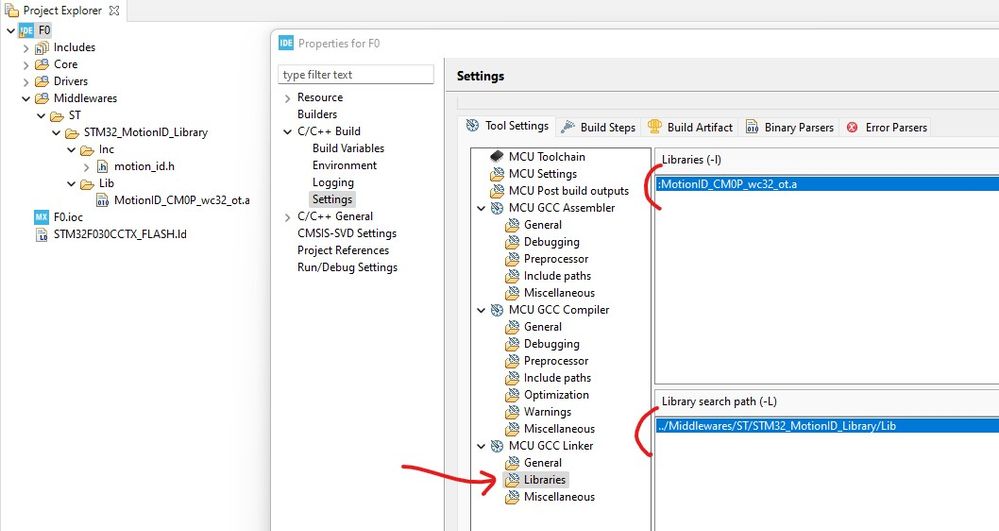

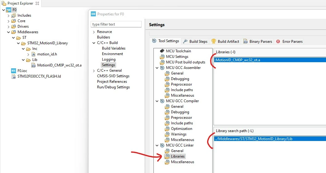

Where do I set the include path on STM32CubeIDE?
  • May 12, 2022
  • 5 replies
  • 6503 views
This really seems like a simple thing, but I cannot figure it out. I am getting a linker error "cannot find -l:libtouchgfx-float-abi-hard.a". I can see the file so I know it exists, but it's not finding it. Adding the file manually to the include folder in project explorer does not work.
Best answer by Cartu38 OpenDev
0693W00000Nps7AQAR.jpgPay attention to ':' char added prior file name. Both are reauired library path AND library name
5 replies
Cartu38 OpenDev
Cartu38 OpenDevBest answer
Graduate II
May 12, 2022
Andrew Neil
May 13, 2022
"Adding the file manually to the include folder in project explorer does not work"
The Include path is for finding Compiler (source code) includes - C header files.
As @Cartu38 OpenDev​ shows, you need the Library path for the Linker to find library files.

If works fine please tag as answered. It will help community to dig shortly to helpful content. Thanks.
Andrew Neil
May 13, 2022
@ksjfhasiudfhask;dfhas​ - like this:
