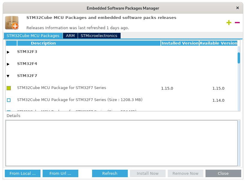

Where are downloaded mcu packages ?
MRech.1
I generated a project with the boad wizard. It actually downloaded a big MCU package. I wonder where this is downloaded and if I can find the corresponding HAL and Low-layer drivers documentation.
I am on Linux.
Thanks

Once download is completed you'll find material repository Thanks Windows > Preferences > STM32Cube > Firmware Updater ... Firmware installation repository field.
All doc is part of package.

However in the document directory, there is only the STM32CubeF7GettingStarted.pdf guide. I have a PDF "Description of STM32F7 HAL and Low-layer drivers" (UM1905) which dates from February 2017. Where is located the latest version ?
Cartu38 OpenDev
Lead III
About doc i guess rely on www.st.com.
​https://www.st.com/en/embedded-software/stm32cube-mcu-mpu-packages.html#resource
Then technical literature > user manual
