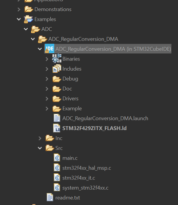

When I click on open declaration, .c file is not opened.
demir
Senior II
When I tried to open the declaration, to see how function works, STM32CUBE IDE does not automatically open the respective .c files in which function declarations exist.
Could you pls point me to the right direction ?

You can also try Project -> C/C++ Index -> Rebuild Index.
If your project doesn't build, fix that first. Your main.c is modified and not saved, could also be causing issues.

Click "Ctrl" key and click on the API you need to show the declaration. But you need to compile the project before.

Unfortunately, that didnt work. Maybe, it is due to scalability settings etc. The .c file I am trying to achieve via open declaration is too big, if thats the case, how can I change it ?
What exactly did you do?
If you right-click on the function name then select "Open Declaration" from the pop-up menu, that should take you to the function.  Or function key F3 also does that (at least in the older CubeIDE version I am running at the moment).

RDrum.1
This normally works for me. But not today.
Restarted CubeIDE- started working again.

after build will product files that files can jump declaration.files is in color blue folder.
