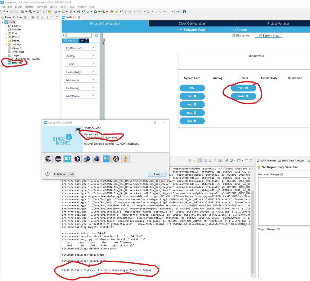

Works like a charm if 1.6.1 based on shared .ioc file.

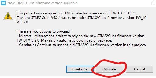

@APavl.10​ which release are you relying on ... @Hampus Dunström​ post is quite old one (1.0.2 release based ...)
Based on promoted .ioc file I've selected migration path allowing to rely on most up to date material what's definitively solving trouble (able to reproduce initial issue if selecting 'Continue')
Mike_ST
