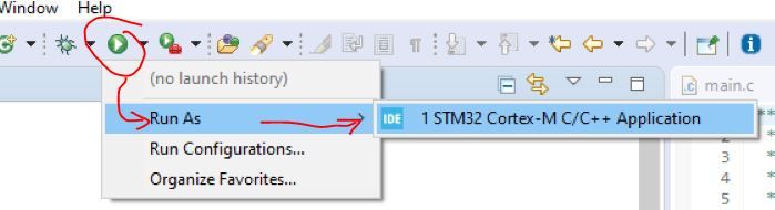

‎2020-07-29 6:40 AM
Since 1.3.0 run mode is supported. Just select your project within project explorer then:

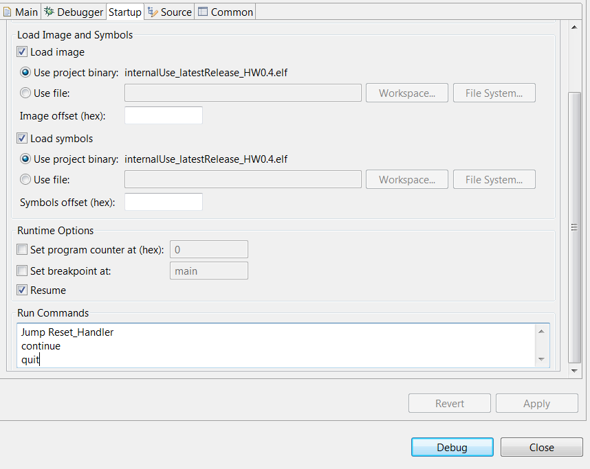

This wasn't implemented in 1.0 as we didn't have time, but it's planned to get implemented at a later point.
For now you can go to the debug configuration to the "Startup" tab and put "quit" in the Run Commands box.
It's the closest thing to a workaround for now.

for me, only adding "quit" did not work out with Segger GDB tool. here is what I needed to add:

I am on v1.4, is there any update on whether this feature has been added yet?
‎2020-07-29 6:40 AM
‎2020-07-29 9:10 AM
Ah I see, thanks. That wasn't very clear to me as usually it is called "flash" or "download" but I guess eclipse is designed more for C++ PC applications rather than a dedicated embedded IDE.
