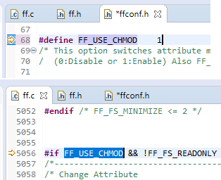

I have noticed very annoying bug in Stm32cubeIDE 1.0.1.
I'm unable to access f_utime function despite "fatfs.h" and "ff.h" files included.
Even stranger is that when I click: Open declaration the IDE has no problems with that....

FRESULT SD_setFileTime(char* patho, DateTime* dateTime)
FILINFO infoo;
// time assign here...
f_utime((const TCHAR*)patho, &infoo); // << ERROR: undefined reference to f_utime
return FR_OK;
Overall, I sometimes encounter errors like this (for example with my own defined functions). Does anybody have any clue why this happens, it's very frustrating :face_with_steam_from_nose:

Header files are not enough to successfully link all compiled source files to a final executable.
Ensure that you compile all source files needed for your application and tell the list of resulting object files and maybe other libraries the linker, which is invoked after compilation. Then the linker should be able to resolve all symbols found in the compiled object files.

I came across this question referring to a problem that I had also.
Luckily I might stumble upon the resolution of it.
If you scroll up in the ff.c you have a define #if FF_USE_CHMOD && !FF_FS_READONLY that in my case were defined in a way that this part of the code were not implemented. I had to switch FF_USE_CHMOD to 1 on ffconf.h
I hope it helps
