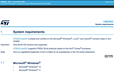

@GongGing wrote:
I have installed the latest IDE in my windows 7 laptop.
Windows 7 isn't supported:
https://www.st.com/resource/en/user_manual/um2563-stm32cubeide-installation-guide-stmicroelectronics.pdf#page=2
via: https://www.st.com/en/development-tools/stm32cubeide.html#documentation
AScha.3
You have to use win11 ...or try older version of cubeIDE :
Version STM32CubeIDE 1.11.2 works fine for me on Windows 7 Professional 64 bit.
Afair i had IDE 1.13.1 running on Win7 /64 .
Just try...
