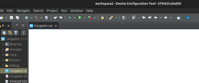

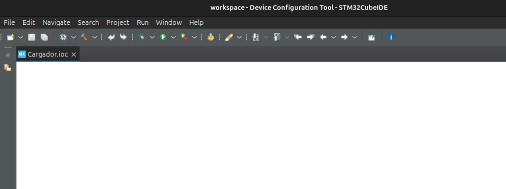

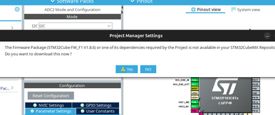

As of yesterday, since an update hit, my CubeMX view won't render (literally it is just a white background). Tried reinstalling and it renders, until I sign up and it updates again, then it stops rendering again. The rest of the IDE works just fine.

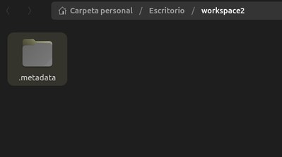

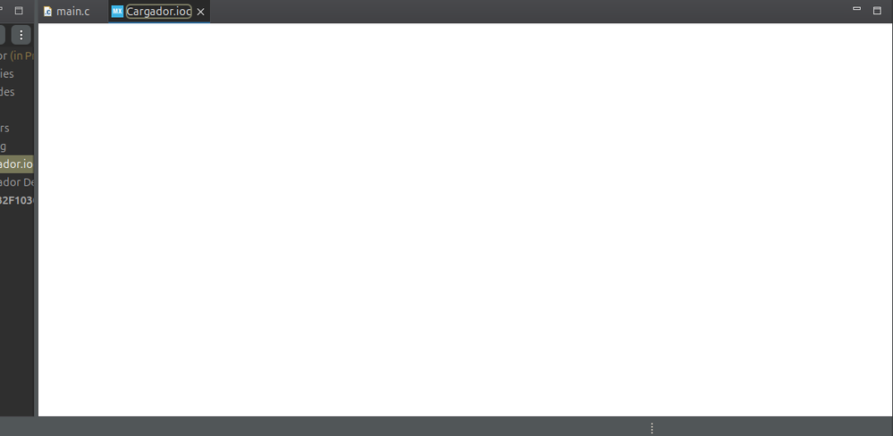

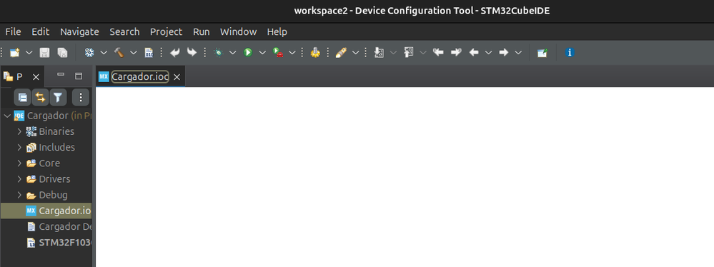

Done in order:
It didn't work. Even with new projects it doesn't work.

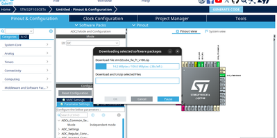

Same over there:
-I downloaded it
-Configured the chip -> "code generation requires packages, please log in"
-log in -> downloads updates and or packages
-tried to generate code -> app doesn't work anymore (freezed)
-close it -> open it -> tried to open the .ioc -> it doesn't open anymore

I've got a solution for Cinnamon GUI, but I have no idea if it works for Gnome, maybe the desired setting located somewhere else, try to find it.
For Cinnamon:
In app menu Right click on STM32CubeIDE -> Properties;
In the launcher properties window set the "Use dedicated GPU if available" checkbox.
On my side the IOC interface started to work properly after that.
