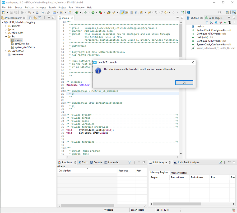

Using this tutorial I went to run GPIO_InfiniteLedToggling as my first example using STM32CubeIDE, but at stage 5 of that tut when it wants us to debug the project (F11), I get that Unable to Launch error:
How to fix this issue, please?

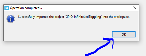

Do you mean the .project file in the following address?0693W00000Hr1h0QAB.pngAfter opening it with the IDE, this message appeared:

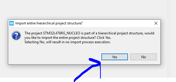

0693W00000Hr1hjQAB.pngI clicked Yes.
The another message:

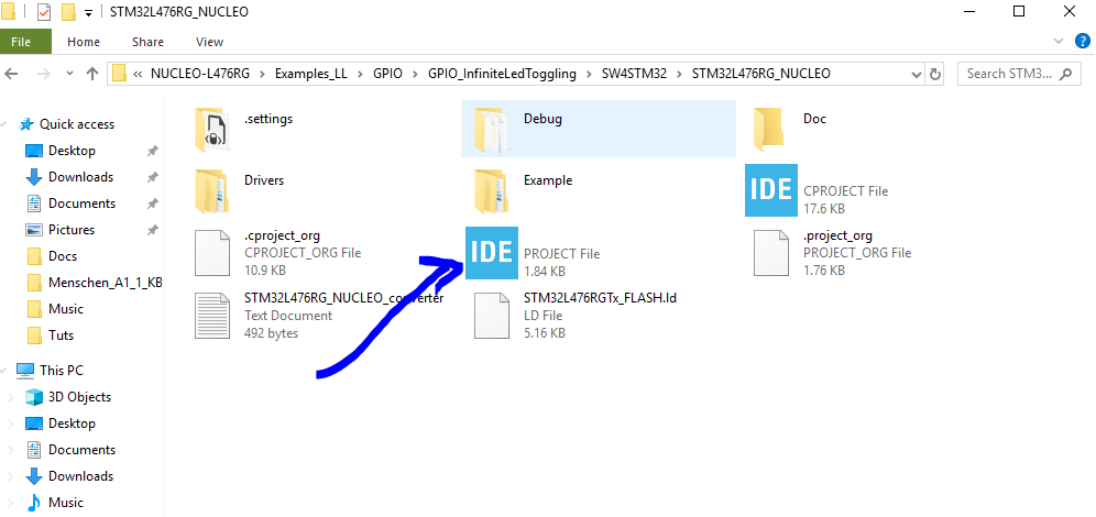

Jan 10, 2022 2:45 PM UTC
That is the file I meant.
I double clicked on that file to open it and ran through these steps myself and had no issues opening the project and debugging.

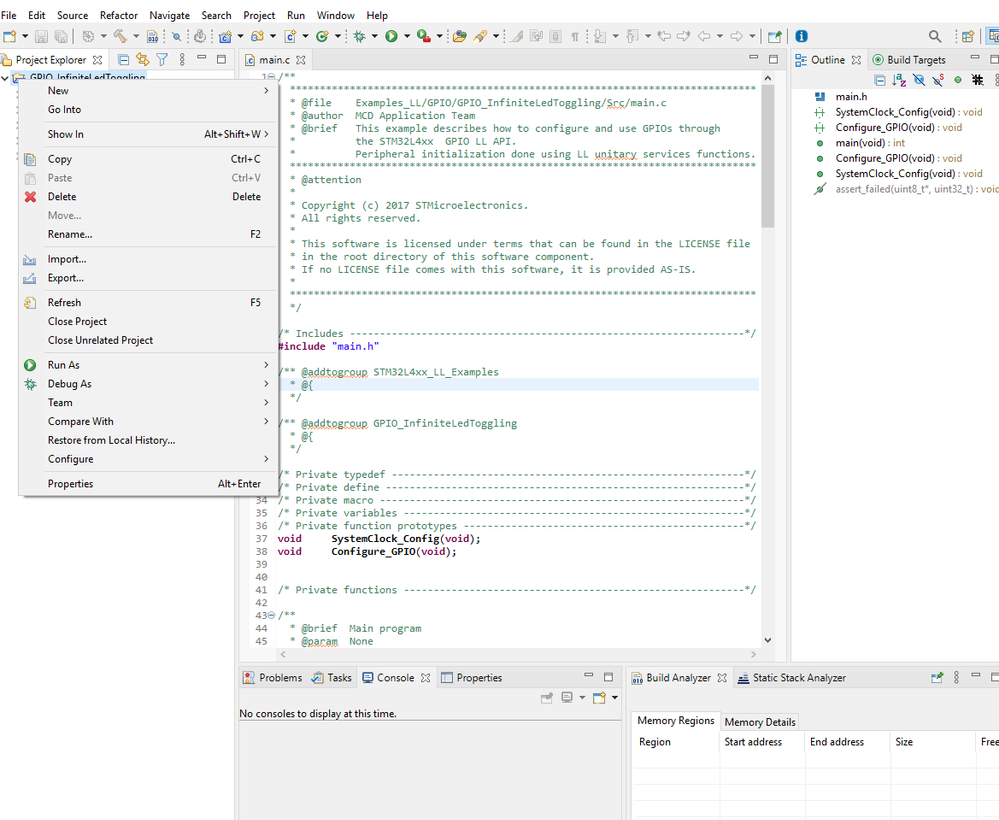

By the way there's no Build option on the pop-up menu when right-clicking the project name:

I actually found the issue just by messing with the files, say, the .project file! That file exists in a little further directory in the address shown in the tutorial. That is, we need to go further to ...\GPIO_InfiniteLedToggling\SW4STM32\STM32F411-Nucleo on the Import Source. That way the project debugs, and runs successfully on the board as expected.
