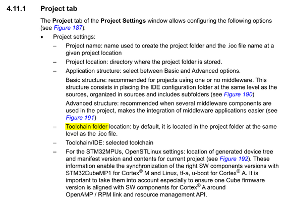

When creating a new CMake-based project in STM32CubeMX, the "Toolchain Folder Location" field is auto-populated with the project folder path upon entering a project name. This behaviour is misleading because the field is intended (at least by its description) to specify the location of the actual toolchain binaries (e.g., GCC ARM) and it is unlikely that a toolchain is installed in a specific project folder.
I have tried to understand what this is by consulting the User Manual UM1718 Revision 49, and there were two references that matched the text "toolchain folder", both of which provided no helpful guidance on what this is actually used for.
This is pretty much the only reference that describes what this option is for, which basically tells you nothing but confirms the toolchain is located in the project folder by default.

Hello @Adam Hamilton
Thank you for posting.
Toolchain Folder Location” does not point to your compiler installation (e.g., GCC ARM). Instead, it is simply the directory where CubeMX generates the toolchain/IDE-specific project files.
It is not used to locate arm-none-eabi-gcc or any other compiler binary.
It is the output folder for generated build-system artefacts, depending on the chosen “Toolchain/IDE”:
For CMake: CMakeLists.txt.
For  STM32CubeIDE:
.project, .cproject (Eclipse project metadata)
.settings/ (Eclipse/STM32CubeIDE settings)
STM32xxxx_FLASH.ld, startup files, etc.

Hi @Ghofrane GSOURI I think you completely misunderstood the intent of my post.
I am very much aware that the Toolchain Folder Location does not point to the compiler installation. This is the reason why I created the post in the first place.
I made the point that the name Toolchain Folder Location has a specific meaning. I am a software developer with more than 20 years experience; with around 10 of those being in a professional setting and in my time, the word toolchain means a set of tools used to transform source code into a final application, and certainly not the build script files.
Please look over my suggestions and see whether these can be incorporated into a future revision of the application because I really like the STM32CubeMX software but I don't want to be jumping through hoops every time I create an application.
At the very least, rename that text box field to Build Script Directory Location. Don't use Folder because this is very much a Windows only name whereas Directory is the proper name.
