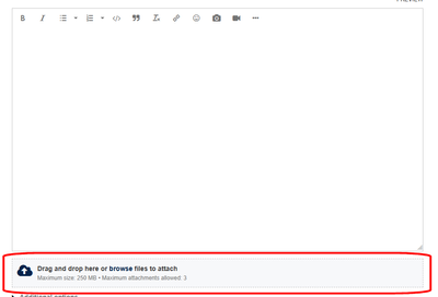

@TDK how and were to include the IOC file. I can't upload the IOC file. Apologies, but I can't upload the IOC file here.
Why not?
You should be able to just drop it into the post editor:
If it's confidential, then raise a private support ticket: https://ols.st.com/s/
Or, can you reproduce the behaviour in an IOC file which you can share?
