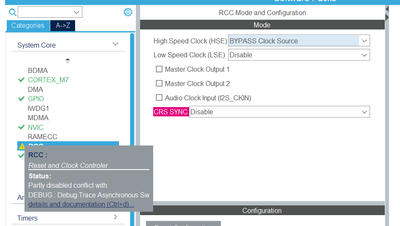

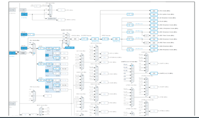

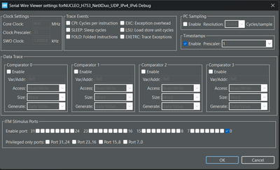

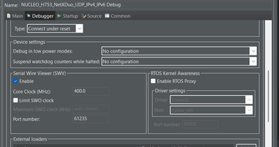

Hii Everyone, I am trying to debug with SWO and SWV in STM32CubeIDE with NUCLEO-H753ZI. But, I am not getting any prints on SWV ITM Data console. As you can see all settings in the below attachments. My CPU system clock is running at 400Mhz. Anyone suggest me to get prints in SWV/ITM Data console.

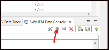

To start the ITM trace you need to wait until the debugger stops at the first breakpoint, usually at main.
Then click the icon on the ITM console toolbar, as shown: It should change color to RED. Then resume execution.
Also, try to limit the SWO clock: up to 4 or 8 MHz, not 12.

Thank you your reply, I did same thing as you said. But I didn't get any prints.
