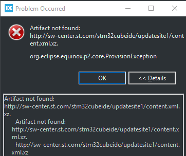

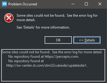

If you are behind a proxy make sure that your settings are correctly set, the reload button may help to validate them.
Otherwise I suggest you to clear your p2 cache by deleting the following folder, and try again Help > Check for updates:
INSTALL_LOCATION\STM32CubeIDE\p2\org.eclipse.equinox.p2.repository\cache

Could you provide more details on the usecase that conduct to this 404 error?
Note that this site is not supposed to display something with a web browser, I also get a 404 error in Chrome even if update-site works like a charm through STM32CubeIDE.
What happen if you press the reload button of STM32CubeIDE repository site?

Hi Julien,
This is actually occurring in the STMCUBEIDE when I go to Help> Check for updates.
I get this error:-
Thanks James

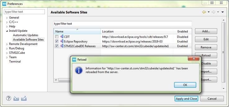

2019-06-19 07:23 AM
Hi Julien,
When I go into the list of available sites and reload i get this:-

2019-06-19 07:29 AM
Definitively clearing you cache will solve the issue.
2019-06-19 07:34 AM
Hi Julien,
I deleted the files from the Cache and that seems to have done the trick.
Thank you for your help.
Cheers
James
