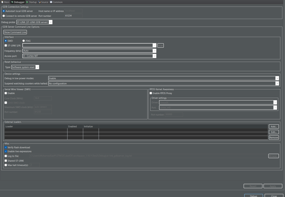

I'm working with a stm32 nucleo H723ZG board. Until yesterday everything worked fine, I could program the board and everything worked well. When I tried to connect my board to my PC today, cubeide could not find the board when I tried to run my program. I did not change any settings. The COM led stays red ( ld4 led ) and the ld6 led stays red aswell and no other leds are on. I tried to erase everything with the cube programmer but I got the error no target found when I tried to connect. here the text I got.

‎2023-03-20 3:36 AM
Try to change the Reset option to Hardware or to None.
‎2023-03-20 3:53 AM
I already did that and it didn’t work
