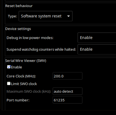

i got quite some difficulties, having this run in a reliable way on a NUCLEO G431KBT6.
It more often does not work, as it would work. It often just wouldnt print anything (But it had before, without issues!). Sometimes the swv debugger couldnt be enabled on debugger start, or the arm-none-eabi*.exe crashed. (i did not made a screenshot - foolish me).
Anyone has some experience with this and could give me some tipps?
Edit:
The red record button behaves a little strange: It wont turn off sometimes, but when clicked, it wont turn on. But after having opened the settings, it is turned on.
- Labels:
STM32CubeIDE
‎2024-10-27 2:53 AM
just from your shown settings: you have to enable SWV (and set: real core clock ) to use it...
‎2024-10-27 2:57 AM
I have. I accidently switched the configuration. I have reuploaded it.
