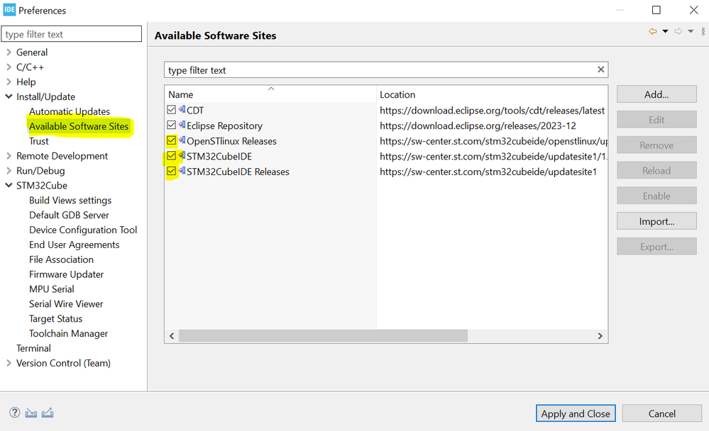

we have an issue updating stm32cube ide.
We get an error
"Valid cert chain, but no trust certificate found!"
like in post:
Solved: STM32CubeIDE 1.13.2 Check Updates failing with "no... - STMicroelectronics Community
But there is no solution, just a "relayed to support".
We solved it some time ago with adding
-Djavax.net.ssl.trustStore=NUL
-Djavax.net.ssl.trustStoreType=Windows-ROOT
to the .ini, but this doesnt seem to work anymore.
Any help here?

Hello @Marco77
Sorry for my late reply,
Please try to reload the available software site in Preferences>Install/Update> as demonstrated in attached screenshot, also don't forget to check the connexion.
Thx,
Souhaib

‎2024-04-15 3:34 AM
Hi Pavel,
while its not the perfect way as there is an update function for the tool, it worked.
Thanks for the hint.
Regards
Marco
