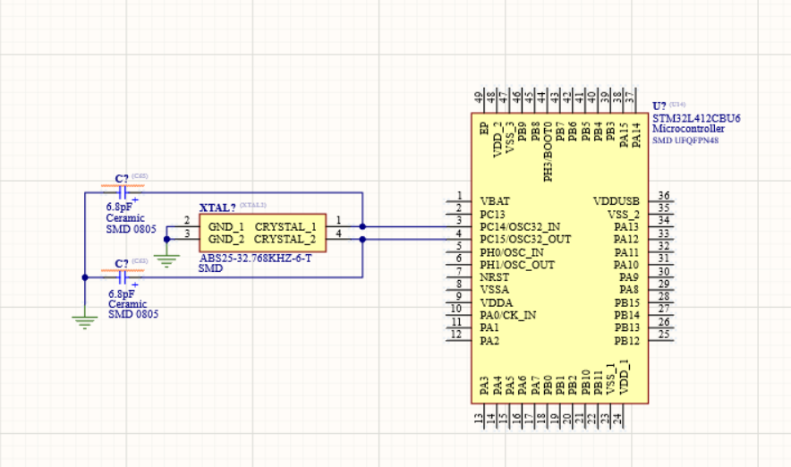

We are using STM32L412 RTC with STM32CubeIDE.
Previously we are using
Crystal - 32.768 Khz SMD Crystal YXC YSX306GA 8.0 x 3.8 mm
load capacitance - 10pf 0805
In Previous Crystal we get about 6 seconds of RTC drift,
to solve this issue, study the application note AN2867 : https://www.st.com/resource/en/application_note/cd00221665-oscillator-design-guide-for-stm8afals-stm32-mcus-and-mpus-stmicroelectronics.pdf
and from this used below setup:
Crytsal - ABRACON ABS25-32.768KHZ-6-T Crystal, 32.768 kHz, SMD, 8mm x 3.8mm, 20 ppm
load capacitance - 6pF 0805
But In new setup we are getting 24-30 seconds of drifiting.
As we are following all guidlines mention in application notes, as compared to previous crystal, but getting more rtc drift (almost 4 time of previous rtc drift)
Please help us to solve this issue.
Thank You

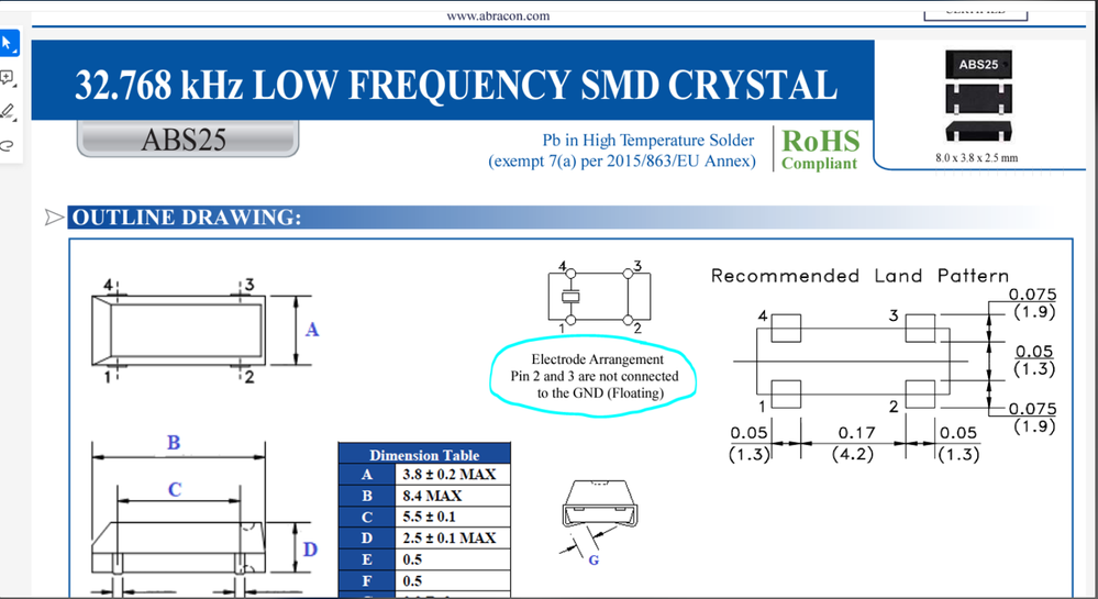

Hello @Peter BENSCH​ , I have some doubt about crystal connections:
As shown in above schematic, crystal pins 1 and 4 is quartz crystal and another two pin (2 and 3) is connected to GND.
In many schematic, we found that some schematic keep crystal other pin floating.
and according to crystal datasheet: https://abracon.com/Resonators/abs25.pdf
Pin 2 and 3 are not Connected to GND (Floating).
So,
1) Is above schematic is ok?
2) What can be impact with GND Connection to pin 2 and 3?
3) What can be impact without GND Connection to pin 2 and 3?

With a load capacitance of 6 pF on a two layer board, a 6,8 pF capacitors are almost surely too small. The appropriate value should be 8-10 pF and I would start with a 10 pF.

We finally solved this issue and concluded, using (Cl1*Cl2)/(Cl1+Cl2)=load_capacitance.
So our value for c1=c2=12pf.
