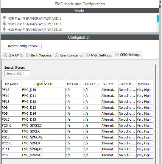

[STM32H750ZB][FMC] FMC_NBL0 and FMC_NBL1 are not considered in CubeIDE1.19.0
I am using STM32H750ZB variant for an HMI custom project and I am using SDRAM via FMC.
When I configure FMC in cubeide1.19.0, I can't see the FMC_NBL0 and FMC_NBL1.
I can actually add these pins as GPIOs, but I can't define the AF as AF12_FMC.
I know from the datasheet that this package supports it but I want your confirmation as I still don't have HW to test and don't want to change the package again and redo the HW.

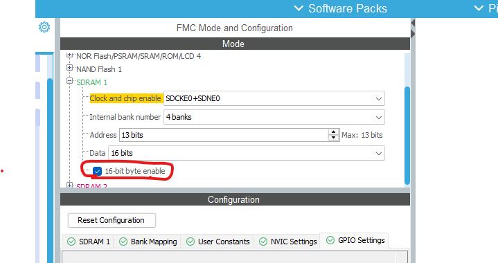

It was my mistake! I didn't check the 16_bit byte enable option!
