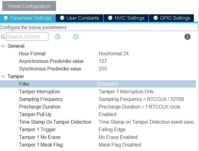

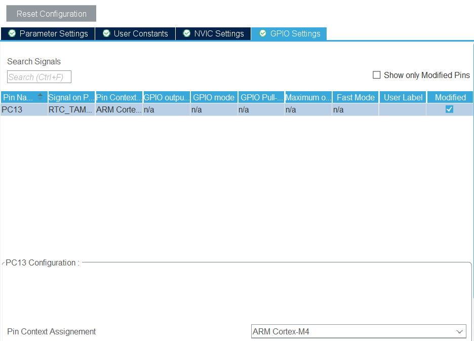

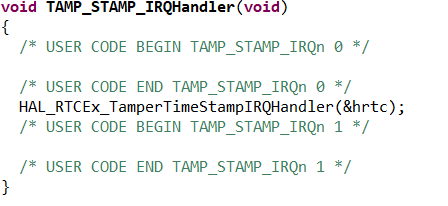

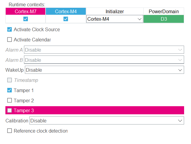

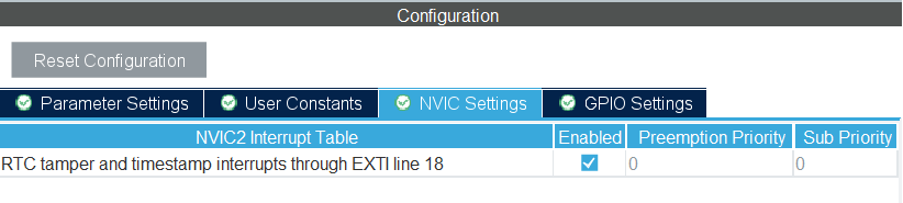

I configured the RTC tamper 1 interrupt as following. (As i did in M7, I only change the initilizer to Cortex-M4)
0693W00000WJiRCQA1.png0693W00000WJiRRQA1.png0693W00000WJiRWQA1.png0693W00000WJiZuQAL.png
This is the same configuration that I use in M7 core and works perfectly. The code that is autogenerated is the same in the M4 core than in the M7 core.

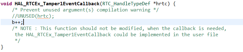

0693W00000WJiRqQAL.pngI add the following code as I did in M7 core.
0693W00000WJiS0QAL.pngBut, the program never enters in the function because the TAMPER_1 is not working in M4 core.

Hello @CVael.1​,
Can you specify the version of CubeMX you are using. Actually, I can find that tamper 1 and tamper 3 should not support it in CubeMX6.7.0
