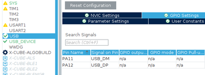

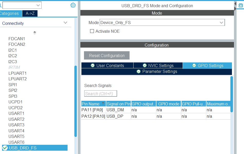

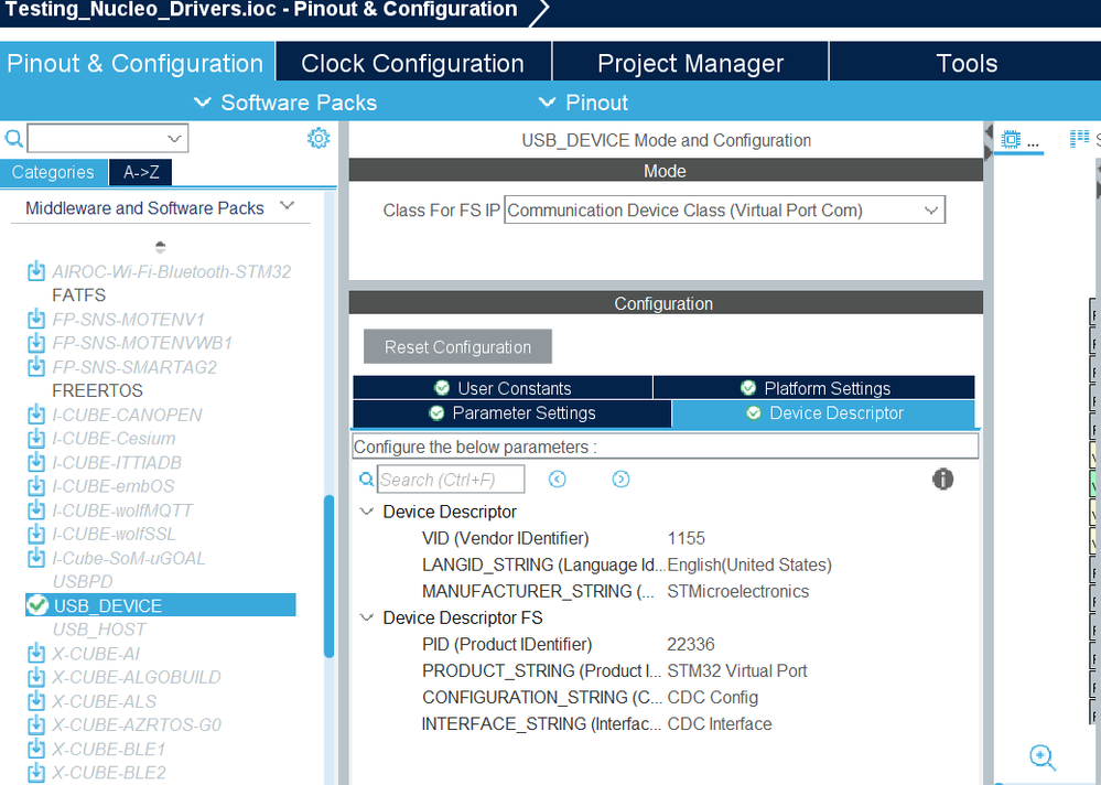

I am currently working on a project involving the STM32G0B1RE microcontroller and had encountered an issue while configuring the USB_DRD_FS (Dual Role Device Full Speed) in Device mode using STM32CubeIDE.
Here are the steps I followed:
  1. I selected the USB_DRD_FS peripheral and set it to Device mode.
  2. I configured the USB_Device in CDC (Communications Device Class) mode under Middleware.
After completing these configurations, I noticed that the GPIO pins associated with the USB_DRD_FS peripheral didn't appear in the generated code or usbd_conf.c

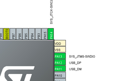

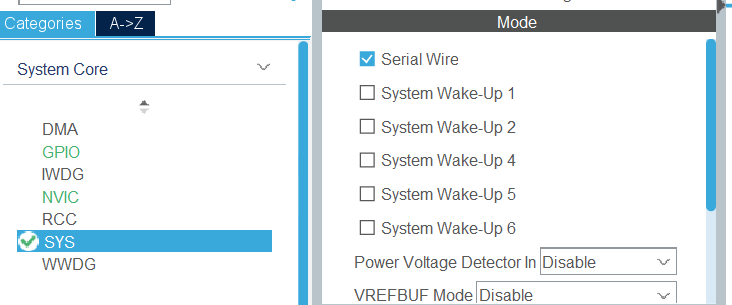

But you set/enable USB in Cube ? see the pins...and pin settings ?
(+ debug enabled... ! )

Am not getting GPIO pins of USB in PCD_Msp_Init

I am testing USB_OTG_FS in device mode on an STM32H7. The USB pins were successfully generated in PCD_MSP_Init.
However, when I attempt to run USB_DRD_FS in device mode on an STM32G0 using the same configuration, the USB pins are not generating.
Please see the attached file for more details.
