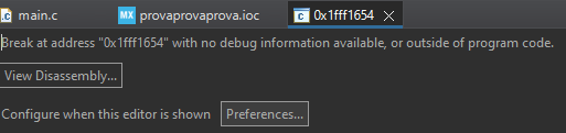

Now I tried to change the resistors that were located between the pins of the microcontroller and the connectors to which SWDIO and SWCLK of the ST-LINK/V2 are connected, and debugging goes with many problems (I remember that before changing the resistors the debugging).
Now that I've changed the resistors, from 1k to 20ohm, I can debug (SWD, Connect Under Rest or Software System Reset, 950khz), but the errors I get are these:
and
Open On-Chip Debugger 0.11.0+dev-00449-g53fa0f7 (2022-06-09-09:42) [https://github.com/STMicroelectronics/OpenOCD]
Licensed under GNU GPL v2
For bug reports, read
http://openocd.org/doc/doxygen/bugs.html
Info : Listening on port 6666 for tcl connections
Info : Listening on port 4444 for telnet connections
Info : STLINK V2J40S7 (API v2) VID:PID 0483:3748
Info : Target voltage: 3.208388
Info : clock speed 950 kHz
Info : stlink_dap_op_connect(connect)
Info : SWD DPIDR 0x0bc11477
Info : STM32G050F6Px.cpu: Cortex-M0+ r0p1 processor detected
Info : STM32G050F6Px.cpu: target has 4 breakpoints, 2 watchpoints
Info : STM32G050F6Px.cpu: external reset detected
Info : starting gdb server for STM32G050F6Px.cpu on 3333
Info : Listening on port 3333 for gdb connections
Info : accepting 'gdb' connection on tcp/3333
target halted due to debug-request, current mode: Thread
xPSR: 0xf1000000 pc: 0x1fff1654 msp: 0x20000e48
Info : device idcode = 0x10006456 (STM32G05/G06xx - Rev A : 0x1000)
Info : RDP level 0 (0xAA)
Info : flash size = 32kbytes
Info : flash mode : single-bank
Error: Failed to read memory at 0xfffffffe
Info : Padding image section 0 at 0x080018c4 with 4 bytes (bank write end alignment)
Thanks for your help and availability

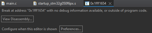

Hi @Piranha​ , I removed R17 and instead of R18 I put a wire to make C1 directly connected to the NRST.
Once this is done... nothing has changed:
and
Info : Target voltage: 3.215717

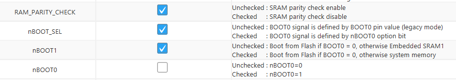

‎2022-12-26 11:56 PM
you still start booloader...
please show actual option bytes: (this was your setting)
nBoot0 is checked now ??
‎2022-12-27 2:53 PM
@AScha.3​ thanks, thanks and thanks again.
I flagged the nBOOT0 and it worked.
Thanks again!
Thank you all for your cooperation
