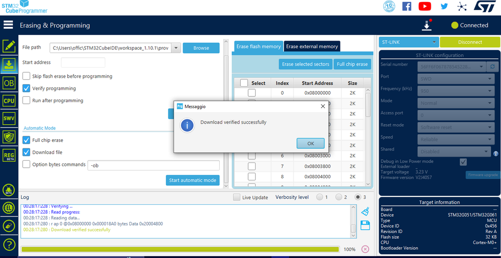

Hi all, I'm new to this STM32 community.
I have a small problem: I bought some STM32G0P0.. for my project, also making the PCB and the rest. But after soldering the various components, I try to program one and see that the level 2 protection is active, I try to program another and there is the same thing.
What I see from the STM32 St-LINK program is that only some memory pages have protection, while others don't, but then going to view the memory areas I see that they have all been set to FFFFFFFF.
Below I can see that the memory on the address 0x08001400 is free, but..
..here I see that is protected! How can I program it?
My question now is: what the hell do I do? Do I ask for a return? Is this a normal thing of STM32G0...? Trying to write a bootloader that makes me jump from one address to another when the memory to read is full?
Thank you for your availability and attention

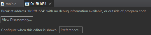

I don't work for ST, you'll need to raise those responsible for CubeIDE and the integration of assorted components.
The 0x1FFFxxxx addresses are indicative of being in the boot-loader.
Perhaps support for STM32G0 is not where it needs to be, I'll flag this upward.

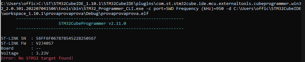

Test1: Try to flash your application relying on CubeProg CLI by using this command:
C:\ST\STM32CubeIDE_1.10.1\STM32CubeIDE\plugins\com.st.stm32cube.ide.mcu.externaltools.cubeprogrammer.win32_2.0.301.202207041506\tools\bin\STM32_Programmer_CLI.exe -c port=SWD -d C:\Users\norlandm\STM32CubeIDE\workspace_IPCEI\STM32F4_RTOS\Debug\STM32F4_RTOS.elf
Obviously you need to modify the two paths in the above example. Does Test1 work well or not?
If not, then we know that the root-cause is isolated to CubeProg CLI ( or potentially the flash loader).
I think this test will be successful. But we have to execute it anyway to narrow down the scope!

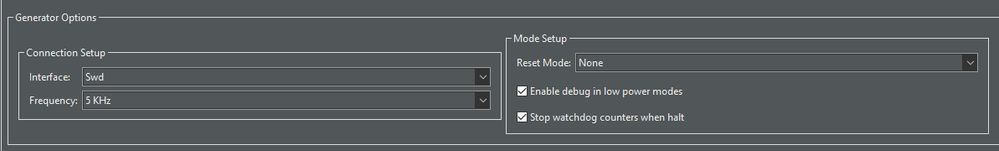

No no, this is not my configuration, I don't know how I managed to take this screenshot.
However my configuration is the same except for the Speed, which I set at 950khz, since with STM32Programmer I can connect to the device with that frequency and not with 4MHz.
If I try to set the speed to 4MHz I get this error:
and this message:

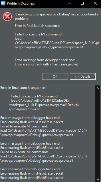

Instead when I try to program it I get the same error as before, but with this message:
Open On-Chip Debugger 0.11.0+dev-00449-g53fa0f7 (2022-06-09-09:42) [https://github.com/STMicroelectronics/OpenOCD]
Licensed under GNU GPL v2
For bug reports, read
	http://openocd.org/doc/doxygen/bugs.html
Info : Listening on port 6666 for tcl connections
Info : Listening on port 4444 for telnet connections
Info : STLINK V2J40S7 (API v2) VID:PID 0483:3748
Info : Target voltage: 3.254557
Error: init mode failed (unable to connect to the target)

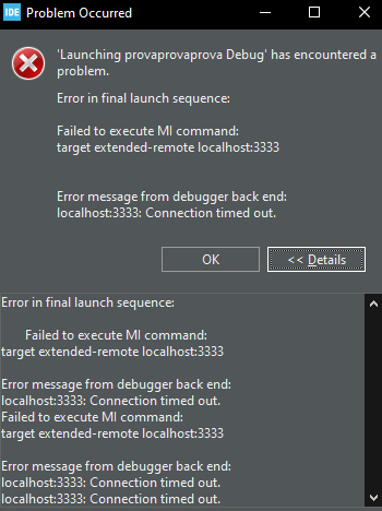

I tried to set "connect under reset" as "reset mode", but I got these error messages:
Info : Target voltage: 3.245115
Info : clock speed 950 kHz
Info : stlink_dap_op_connect(connect)
Info : SWD DPIDR 0x0bc11477
Info : STM32G050F6Px.cpu: Cortex-M0+ r0p1 processor detected
Info : STM32G050F6Px.cpu: target has 4 breakpoints, 2 watchpoints
Info : starting gdb server for STM32G050F6Px.cpu on 3333
Info : Listening on port 3333 for gdb connections
Info : accepting 'gdb' connection on tcp/3333
Error: timed out while waiting for target halted
Error executing event gdb-attach on target STM32G050F6Px.cpu:
C:/ST/STM32CubeIDE_1.10.1/STM32CubeIDE/plugins/com.st.stm32cube.ide.mcu.debug.openocd_2.0.300.202206090745/resources/openocd/st_scripts/gdb_helper.tcl:18: Error: TARGET: STM32G050F6Px.cpu - Not halted
in procedure 'gdb_attach_hook' called at file "C:/ST/STM32CubeIDE_1.10.1/STM32CubeIDE/plugins/com.st.stm32cube.ide.mcu.debug.openocd_2.0.300.202206090745/resources/openocd/st_scripts/target/stm32g0x.cfg", line 128
in procedure 'first_gdb_attach_hook' called at file "C:/ST/STM32CubeIDE_1.10.1/STM32CubeIDE/plugins/com.st.stm32cube.ide.mcu.debug.openocd_2.0.300.202206090745/resources/openocd/st_scripts/gdb_helper.tcl", line 18
Info : device idcode = 0x10006456 (STM32G05/G06xx - Rev A : 0x1000)
Info : RDP level 0 (0xAA)
Info : flash size = 32kbytes
Info : flash mode : single-bank
Warn : GDB connection 1 on target STM32G050F6Px.cpu not halted
Warn : GDB connection 2 on target STM32G050F6Px.cpu not halted
Error executing event gdb-flash-erase-start on target STM32G050F6Px.cpu:
Error: Target not halted
Error: failed erasing sectors 0 to 3
Error: flash_erase returned -304
Info : dropped 'gdb' connection
shutdown command invoked

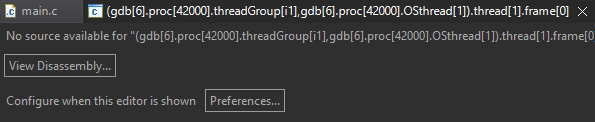

I tried to do test 1, setting only the port in the first time, then, after seeing that it didn't detect an STM32 device, I also tried to set the frequency, but nothing:
For test 2, following all your directions, it still doesn't go debugging.
The error messages are these:
0693W00000WKbB9QAL.pngand
STMicroelectronics ST-LINK GDB server. Version 7.0.0
Copyright (c) 2022, STMicroelectronics. All rights reserved.
Starting server with the following options:
        Persistent Mode            : Disabled
        Logging Level              : 1
        Listen Port Number         : 61234
        Status Refresh Delay       : 15s
        Verbose Mode               : Disabled
        SWD Debug                  : Enabled
        InitWhile                  : Enabled
Waiting for debugger connection...
Debugger connected
Debugger connected

Hi Franz,
Hmm... Let me tie back to Test2! Are you saying that CubeProg GUI version could connect to the device and flash the binary successfully??
0693W00000WKdSRQA1.pngPlease confirm. Even please put the CubeProg log information with verbosity level 3?!
It would be very weird if CubeProg GUI work and CubeProg CLI does not work... We need to clarify this first.
You could also drop me a PM if we should setup a remote session.
But let's await your feedback on Test2...
