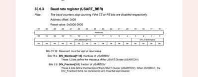

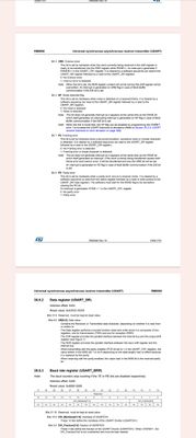

Hi, I want to use USART2 as transmitter on stm32f429zi mcu (nucleo board). I configure registers as in the picture, but transmission don't work. I use USART2 on PA2 pin and I need transmission with 115200 baudrate, alternate function is AF7 and usart2 is connected to APB1 bus with 45Mhz default frequency. Where did I make a mistake?

I suggest you to take a look at your bauderate configuration.
You can refer to this exemples.
On the RM0090 . Also, is better to use fast speed. For the data register, I advise you to create a function to transmit your data that is better to put it in a uint8_t variable and then append this variable to your data register. Finally, don't forget to make sure that you are connecting your TX to the external peripheral Rx and RX to TX. And if you are using a serial monitor, maker sure that all settings works fine. Finally, if the issue persist, you can try to debug your code.

I suggest that you start a new project in CubeIDE, set up the clock and enable UART2, then have it generate code. Then compare ST's code to yours and see what the differences are.
FBL
Maybe you should check the desired baud rate,
USART2->BRR = (7<<0) | (24<<4); // Baud rate of 115200, PCLK1 at 45MHz
Best regards,
FBL
At 16-OVER mode it might be easier to see if USART2->BBR = 45000000/115200 or (45000000/115200)-1 works better.
