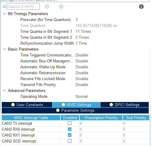

I'm using a CAN bus on my STM32F446RE. Right, now, the CAN communication is working with only one rx filter. I saw in datasheet that we can use up to 128 filters. I don't need so many filters, but I'm trying to configure a second filter. Unfortunately, when I do this, the MCU does not receive any message (although it compiles without error).
So my question is : how can I config two CAN filters with HAL library ?
Here is my code ( sFilterConfig2 is commented because it is the part that breaks my application) :

	hcan2.Instance = CAN2;
	hcan2.Init.Prescaler = 3;
	hcan2.Init.Mode = CAN_MODE_NORMAL;
	hcan2.Init.SyncJumpWidth = CAN_SJW_1TQ;
	hcan2.Init.TimeSeg1 = CAN_BS1_11TQ;
	hcan2.Init.TimeSeg2 = CAN_BS2_2TQ;
	hcan2.Init.TimeTriggeredMode = DISABLE;
	hcan2.Init.AutoBusOff = DISABLE;
	hcan2.Init.AutoWakeUp = DISABLE;
	hcan2.Init.AutoRetransmission = DISABLE;
	hcan2.Init.ReceiveFifoLocked = DISABLE;
	hcan2.Init.TransmitFifoPriority = DISABLE;
	if (HAL_CAN_Init(&hcan2) != HAL_OK)
		Error_Handler();

Additionnal infos :
  • I use STM32Cube IDE
  • NUCLEO-F446 RE board
