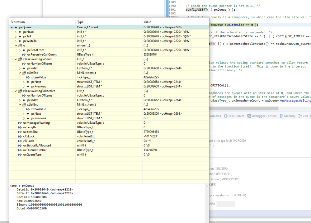

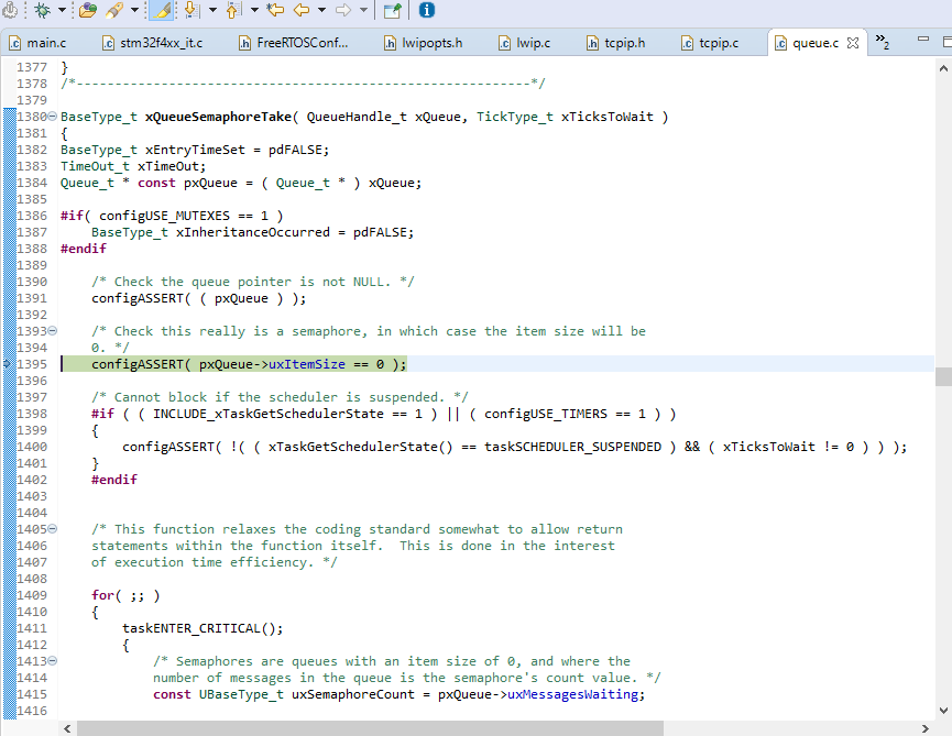

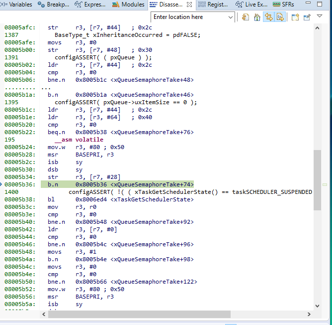

After 12 hours the program eventually hung and this was captured by the debugger:
XKwau.1
XKwau.1
Piranha
Chief II
Those images doesn't help much... Call stack could provide something useful, but there is no sense in spending time on such debugging until the fundamental bugs are fixed.
  1. At least MX_LWIP_Init() and EthInitTask() are not respecting lwIP multithreading requirements.
  2. Link status processing code misuses NETIF_FLAG_UP instead of NETIF_FLAG_LINK_UP and the respective wrong API.
All of this and more is described in my topic... Additionally your code uses CMSIS-RTOS mixed with FreeRTOS native API, which can easily break things.
