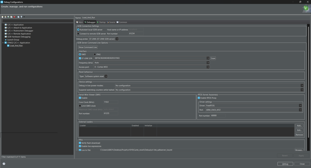

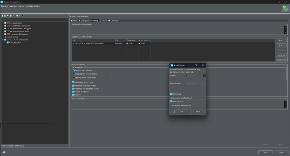

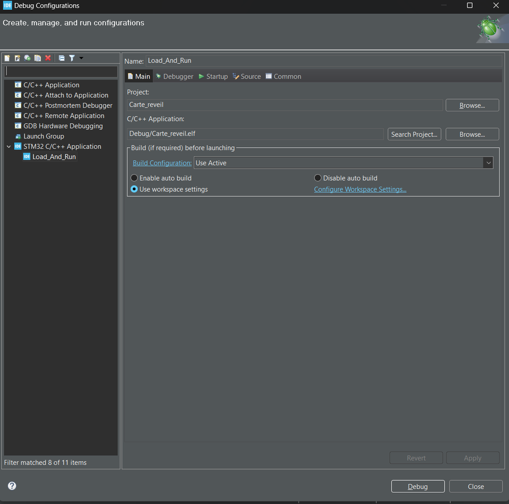

ABouk.1
I have downloaded the latest STM32CubeIDE version (1.16) and set the debug configuration (ST-LINK GDB). Now, starting a debug session doesn't erase the flash/load the program and jumps directly to the program already existing in the FLASH memory. I have checked the "download" checkbox in the startup tab
