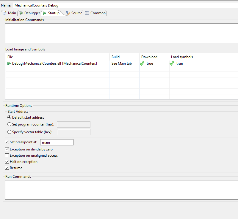

Lately the reset button doesn't work properly anymore .
When i press the "bug" button to debug, the program jumps to main(), but once i have let the program run and press this button
0693W000008wWL4QAM.png0693W000008wWKuQAM.pngIt runs the program without break at main, when i pause the program i see space in memory without debug info.
The debug settings seems ok.
what can be wrong?

Have you set up a restart configuration? You can find information about it in chapter 3.5.7.2 in the user guide which you'll find here.
It might also help to untick the "Resume" box.
