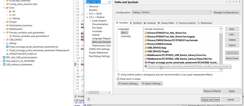

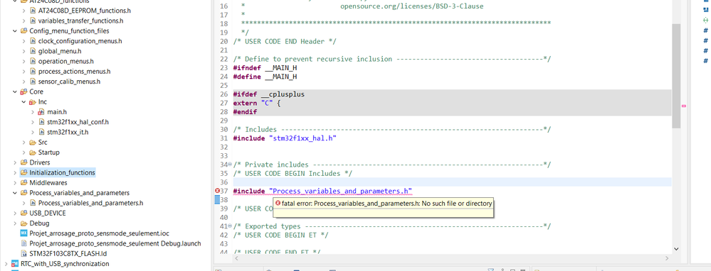

I know this has been discussed before before, but for some reasons, I still can't make my project compile without having errors in it, because of including one file. I have included the path in "Paths and Symbols" tab.
Code in "main.h" file
This is the only line of code I added in the main.h file. What is inside this file is as it follows:

the fatal error says that it cannot find the .h file. Fix that first. The .h file content is irrelevant at that point. Sometimes, the error messages show in the GUI are outdated, try F5 (Refresh) and re-build. But, if the error persists, double check that you have added the correct path under "Paths and Symbols" > "Includes" for the configuaration you are building. In the Build Console, the compile lines "arm-none-eabi-gcc "../Drivers/STM ..." contain all include paths (-I) gathered from the GUI settings.

So, I tried to refresh, but nothing really changed. Also, I can show you my Paths and Symbols GUI

@FGerm.1​ Notice that all your include directories are marked with ! icon. Eclipse cannot find these paths.
If the .project is in a subdirectory of your project, the relative paths should begin with ../
Or better (as Eclipse suggests) avoid relative paths. Instead always begin the paths with ${ProjDirPath} or other variable that resolves to absolute path.
-- pa
By default, stm32cubeide uses these paths, no? I don't know Eclipse that much so I'll probably be asking you a lot of questions about it. So if I want to include an absolute path, sould I just type the whole path starting from C\ in the GUI?
