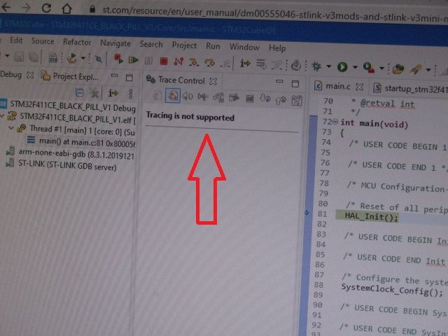

0693W000008wr7hQAA.jpgHello,
I am trying to get tracing working and when i start the debugger this window pops up saying "Tracing is not supported".
Any one have any idea what it means as i can't find any reference to it.
I have a STM32F411CEU6, watched many how videos and configured everything.
I have STLINKV3MINI with latest update, Cube is Version 1.6.
Turned on all the features I need to but Tracing I guess won't run as somewhere/how i have not enabled something.
I have added SWO wire to the the B3 pin/STLINKV3MINI and can see it streaming data on my scope
Any ideas please as i have spent five days trying to get this to work =)
Many thanks in advance imk
Best answer by Iknig.1
Hello KnarfB and many thanks for the help.
So someone on another forum has tried my project and got it to start tracing by changing the port to 61235
So i have changed my port to 61235 and it works :)
However look at the output from the Debug session startup, it has both 61234 and 61235 port startup requests.
Many thanks Ian

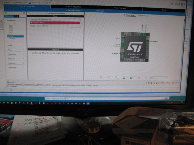

0693W000008wuXTQAY.jpgHello KnarfB and many thanks for the reply,
Noted that it works for you and i am most grateful as this is some assurance that it does work in 1.6 so maybe my STLINKV3 (I don't think so)
However I have posted this to another forum and someone on that forum has downloaded my project and found that it does NOT work in V1.6
However when they create a project themselves the trace function works in v1.6.
Hence there is something wrong with my project, the problem is what.
I have already watched the video you sent me (many thanks) and about another dozen videos and have regenerated this project COUNTLESS times.
So i am wondering if multiple regeneration have messed up the project.
BTW what should i be setting up in .IOC SYS Mode and Configuration please as i get a red bar warning.
see photo
Again many thanks for the help imk

KnarfB
March 15, 2021
Hi Ian,
glad you found it.
The red bar warning only means that you cannot activate that feature (wakeup-pin) because the resources are already allocated elsewhere. Hovering with the mouse over the bar should reveal a more detailed explanation.
hth
