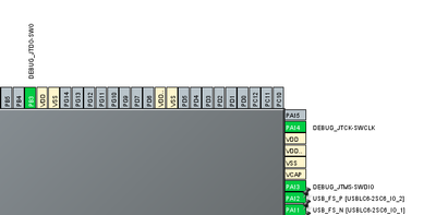

Tip:
Always set in Cube (at first ! ) the debug connection you want to use enabled :
because this is on GPIOA :
So if you not do this, and use these pins for anything else - you stop any debug connection at this moment.
The tutorial I am using hasn't covered this so far.
However, your post prompted me to redo the first lesson from scratch.
In doing so I was instructed to use GPIOB, not GPIOA.
The first lesson now works.
How I ended up with  GPIOA in lesson 1 has me baffled as it originally did work.
I will check other lessons for GPIOA usage keeping in mind your advice.
