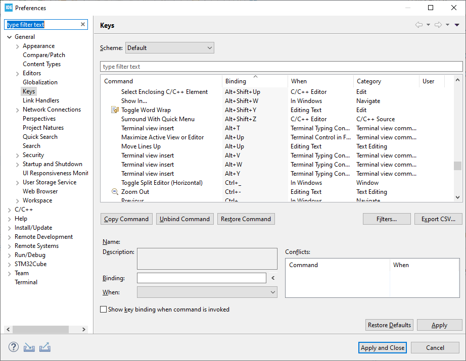

STM32CubeIDE Version 1.2.1 in the editor I Can't Type Tilda ~ .

On my keyboard, that character is bound to an AltGr key combination.
Check the CubeIDE/Eclipse key assignments (usually Window->Preferences->General-Keys), perhaps it is by default associated with some editor function.
TŞEN.1
Mine is bounded to AltGr too. I have checked the bindings but nothing assigned with altgr key.
I'm copying Tilda from somewhere else and pasting in editor and it's really annoying.
Eclipse has multiples layers of settings, with some kind of inheritance.
There are e.g. generic editor settings, and almost identical C/C++ specific ones. Might be worth to go through them.

For Tilda ~ i need press another key. Like "~w" it is okay it Works here, Works every editor but not in cubeIDE editor.
Sadly I couldn't have find any settings.
