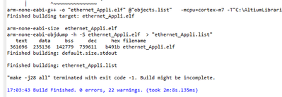

Here is a co-worker's build output, which is "good":

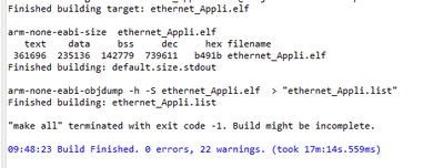

Here is MY build output that is "bad". I cannot get the "terminated with code -1" to go away:
Your build has not completed successfully, this is why debugging step won't start.

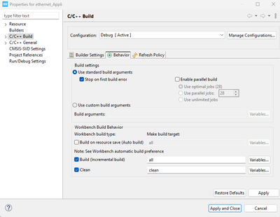

To understand why build fails, please remove temporary -j28 to run only one command at once. See which one fails.
I disabled parallel build, but exit code -1 still occurs, see below. Any other ideas? I'm running STM32CubeIDE version 2.0.0.  Perhaps I'll go back to 1.18 or 1.16

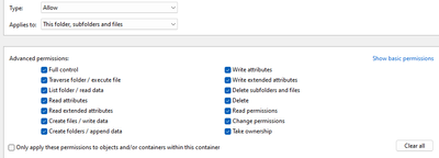

It's odd that the ELF is generated but exit code -1 is reported. This could be a file system issue, maybe insufficient permissions on something it's trying to generate. Does the ELF and LIST file shown in the log exists on disk?
Windows may be objecting to using C:/Libraries as a project directory instead of something within user directory.
Try creating a workspace under C:\Users\%USERNAME%\Documents and generating the project there and building.

Very good ideas.  I tried creating an IOC and project in my user directories, but it's still doing the same thing. Here's a screenshot of the permissions for my user directory:
I tried a few times in different subdirectories of my user directory.  It's possible that it could be related to security protections on this PC.
