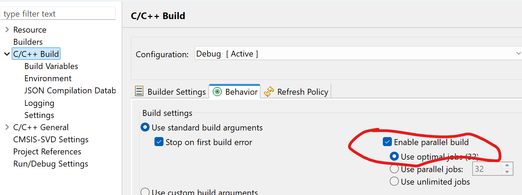

Hi, I'm using stm32cubeide version 2.1.1 and version 1.15.1/windows11, both are compiling the same project on my PC at slower speed compared to a lab computer.(3min vs 20seconds) Any idea what could be causing the issue? Thanks!

For fastest builds, ensure parallel build is enabled in right click project -> settings

Also settings (parallel..) have some effect on multi-core system.

I'm using my local drive for the project. The build settings are similar on both PCs
